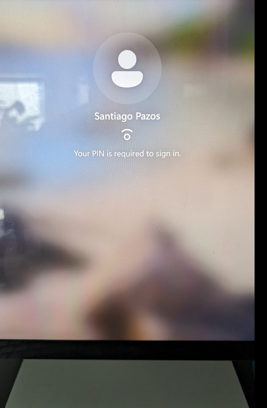

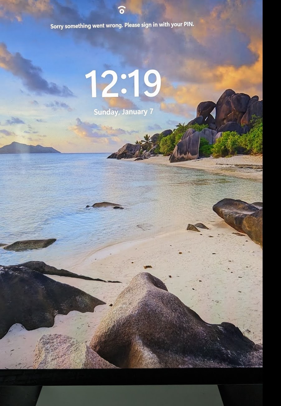

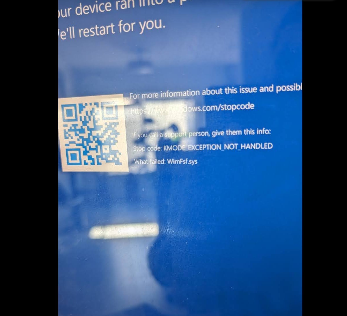

Hello everyone,
For more than 2 hours, I have been unable to log on my Surface Studio 2. I can't past through the initial Windows Hello screen.
I have tried everything, including starting the computer in safe mode, but the system is not even giving me the option to select troubleshoot or input my PIN.
Here some steps I followed:
-I force shut down the computer twice so it would activate safe mode
-I did the same but restarted the computer while holding shift
-A blue screen showed up, See attached. No message to troubleshoot appears
-Windows Hello says 'looking for you' but fails to find me
-Then it says to add my PIN, but no box to input my PIN shows up
-WH says 'something went wrong'
And back to square one
Please any help? Attaching some pictures I took in hopes this provides more clarity.
Thank you

    Hello Santiago,
    Thank you so much for your response and I totally understand the situation you are in right now with your Surface.
    Since you were able to force your device to shut down and still issue persist to happen, and you also don't have the option to input your pin code. Plus, it also routed your device to a blue screen. The best thing I could recommend is to do a clean installation to your Surface, yes this will wipe out everything from the Surface.

    But it seems what you are asking me to do will wipe out the entire content (files, photos, etc) off my faulty computer? Aren't any other options we can exhaust first?
    FYI: I went into recovery mode, I select safe mode, but instead of the typical black safe mode screen, the system takes me to the main desktop page but no commands, just the netwrok and power buttons on the inferior right corner.
