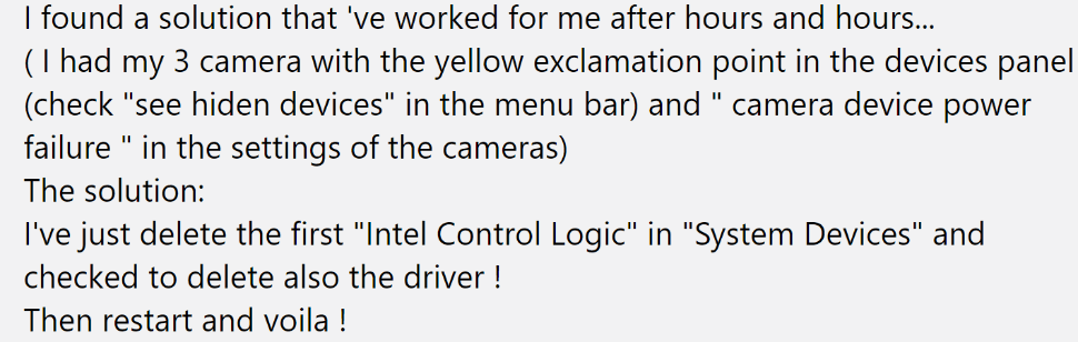

    3. If anyone has a screen shot of the issue showing the error state before applying Jeff's fix, I'd appreciate it if they could post it (I'd like to try to get this to enngineering). Here is Jeff's fix:

    I have been battling the problem of all three cameras on a Surface Pro 6 for a full 10 hours. Error shows up in Device Manager as a power failure on the three Microsoft Camera devices. I tried lots of suggestions short of rebuilding the computer. None of them worked.
    This one did - changing the device driver for the first of the three "Intel(R) Control Logic" devices back to a previous version and voila - a reboot and the power failure errors on the three camera devices has gone away and the camera app now works.
    Thank you so much for your post.
