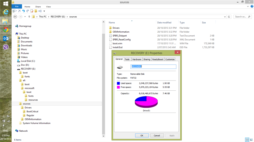

When trying to reset or refresh my Surface RT, I receive the following error:
Could not find the files needed
If you have a Windows installation or recovery media, insert it and restart the PC from the media.
Obviously, the Surface RT comes with no such media, so I'm unsure what to do.  I think there was a way to fix this error on Windows 8 by moving the install.wim file over and doing some command line entries, but given I can't find an install.wim for RT, that is kind of not possible.
I can confirm that per Disk Management, the recovery partition is there, as is the EFI partition and the main Windows partition.
-Justin

The good news is that there are recovery images available for download for Surface RT Here.
Keep in mind that these images are of Windows 8.0 RT, and you will have to apply all updates, install the 8.1 update, then the following updates.
After creating the Recovery USB, you can find directions on using it Here.

2014-04-07T19:00:36+00:00
When you update the surface rt to windows rt 8.1, it also updates the recovery partition to 8.1.

2013-11-04T00:14:12+00:00
You can try to copy/paste the image from the USB pendrive onto another to have a backup of it.  Microsoft had before made available image files for people in the past and that seemed to work.
If your tablet still has the recovery partition, it will be empty and leave it alone!!!  REMEMBER, I said to leave the partitions alone.  Reason being is that if Windows 8.2 ever is made or Windows 9, that new installation will create a new image file and it needs somewhere to create it.  I think you can see the picture of that now.  No partition, no recovery image.
If you go to "This PC" and look at Drive C:, before you moved the image off of the tablet, you had about 48% free space.  After you moved the image file off of the tablet, you should have a lot more free space available on Drive C:.  The system should have readjusted the partition sizes to give you more space.
All in all, you have moved the image off the tablet, you should now have more free space for Drive C: and if you need more storage, just plug in a micro-SD card.  You have a potential unlimited storage by that method.  On my RT, I have all of my files on a micro-SD card (documents, pictures, music, and videos) and have no files on the tablet itself.  No problem.  The Xbox video, music, and pictures apps will read from the micro-SD card.  You have to wait a few minutes after the app first loads and then you will see it populate with your files.
In the future and if you get a new tablet, leave the image file alone and leave it on the tablet.  Again, you can always add more storage with micro-SD cards.  With a handful of those things, you could store the entire Library of Congress and eat up no space on the tablet itself.
Never, ever tinker with the file structure of the RT class tablets.  You could end up with an expensive lump of aluminum and glass that could be dead as a rock.  That is also not covered by the warranty!

Well, if you did create the USB Recovery Drive, then you are going to have to contact Microsoft Technical Support if the tablet is not booting up at all.
Personally, I tell people to never touch that image file and just leave it on the SSD card even though it eats up over 50% of the space for a 32GB model.  Now you can see why.
When you created the USB Recovery pendrive, it should have removed the image file from the SSD card.
You need to insert the USB Recovery pendrive in the USB port and then press the Volume UP and the power buttons at the same time.
I think from what you are writing is that you are just exploring the options of it.  Go to the Desktop and open the file manager and look at the drive list (Local Disk C:).  If you have the 32GB model with no data on it, over 50% of space should be used up.  That would be the installed system plus the recovery system.  If you only have about one fifth space used, that means the recovery system is gone off of the tablet.  If it is missing from the tablet, then that USB pendrive that has the Recovery system will be needed each time you need to do a REFRESH or RESET (recovery).  DO NOT LOSE THAT PENDRIVE!  If you do or if the pendrive encounters a problem and will not function; Microsoft Technical Support is your only hope.  You cannot attach an external DVD drive and install from a Windows 8 disk for a RT.  There is no image file available as a replacement.

    2013-10-28T08:48:03+00:00
    That office suite is in that folder you mentioned with the oem software, to include the motherboard resource drivers.  Those would have been kept separate from the operating itself and installs along with the recovery.
    It looks to me that your recovery setup is correct.  As for the office suite itself, I have not looked for it to know what the image file is for it but best leave alone.
    Looks like your tablet is functioning and if you are missing files, try doing a Windows Update.  If that doesn't work and the missing files cannot be retrieved from your image, then the image is corrupted and you may have to still get with Microsoft Technical Support and they may have an image file for 8.1 RTM so that you can re-create your USB recovery.
    If they do and you succeed in creating the recovery and restoring the tablet 8.1, LOCK UP that pen drive so that nobody can get to it.
    I had learned that lesson the hard way with HP laptops where you create the media from the onboard image and there was an option to just leave it on the laptop.  I found out later that I should have left it on the laptop.  The DVD media had a defect and didn't display an error during creation.  The same goes when creating the USB pen drive recovery.  It is a direct dump and there is no error checking and the USB pen drive itself could have been the problem.
    In the future, if you get one of the newer tablets, just leave the image file alone.  You can always add more storage with micro-SD cards.  I do that with my RT and have not one single problem with it.  All of my files are on a micro-SD card which means that my 32GB RT still has 48% free space on it.  Now, Metro UI apps can only be stored on Drive C: and are hidden on top of that, so, be conservative on the number of apps you install on the tablet.  You do that and you won't have a problem in the future.
    Now, if you want to try it since the recovery is still on the tablet, you can keep the USB pen drive off of the tablet and try to perform a recovery with it.  If it is 8.0, GOOD!  There is a command that you can locate here on the forum to type in to force the 8.1 RTM upgrade via the Store and you should be able to redo the tablet that way.  A lot of work involved, but maybe worth it.
