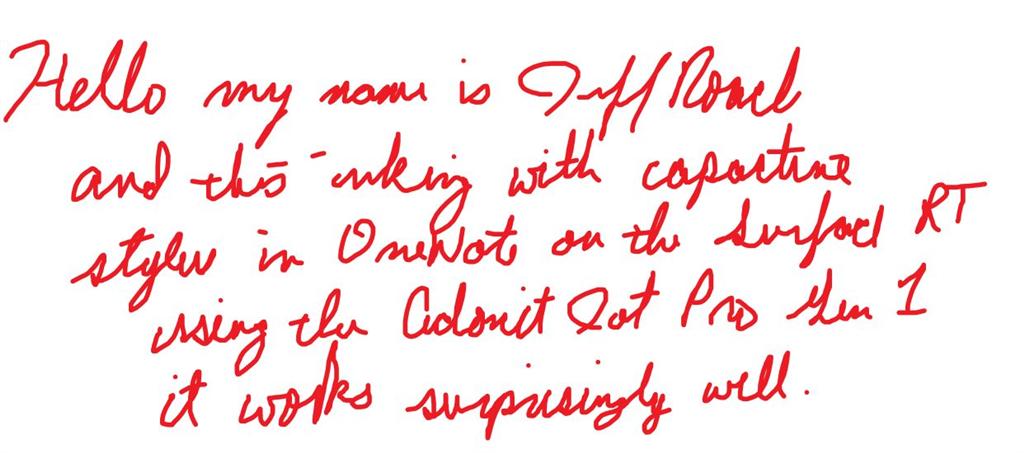

If your goal is inking the only one I've found that works well is the Adonit Jot Pro but isn't great at using for navigation, just make sure your screen is clean before using it. For navigation and scribbling the occasional note the Wacom Bamboo Capacitive Stylus with the firm nib works well, but inking isn't great.

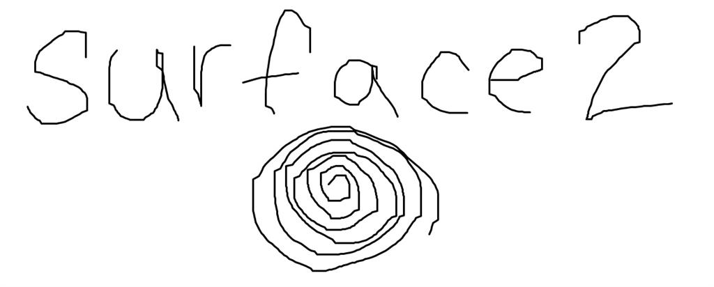

2013-01-29T21:21:24+00:00
Hi Stu_22,
Currently there is no feature to change screen sensitivity. It could be the screen protector that is causing the discontinuous lines.
Try drawing lines with your finger, and let us know if it replicates.

    2013-12-01T15:01:34+00:00
    Im having the same problem i get very squiggled lines all over and i have tested with my fingers and the adonit jot pro.i dont have a protector.
