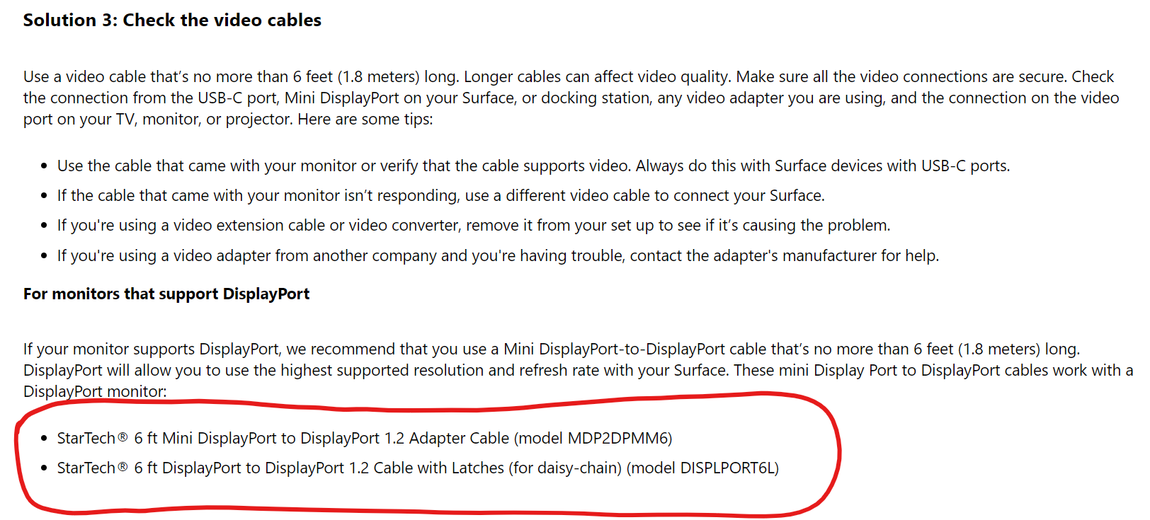

    Has anyone tried using these cables stated in Microsoft's website? I also posted a link to the amazon site below:
    https://www.amazon.ca/StarTech-com-Mini-DisplayPort-Adapter-Cable/dp/B002XVYZ82
    If anyone used these cables with the Surface dock, have you experienced any issues with them?
