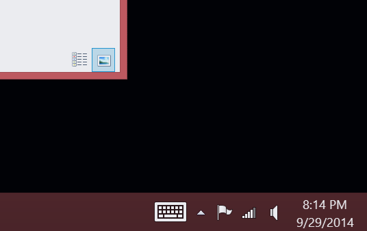

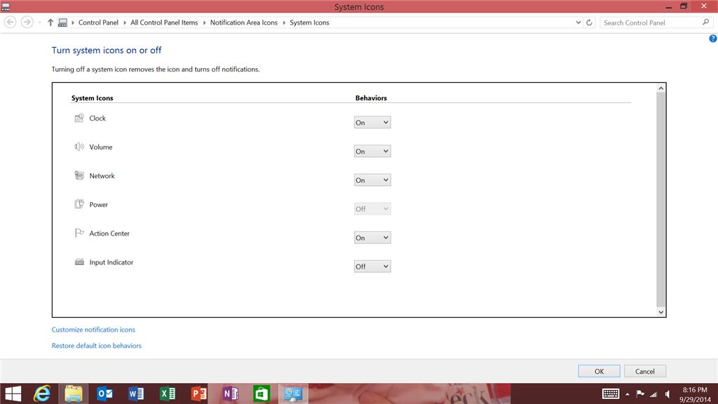

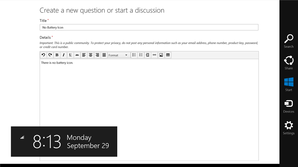

I understand that you are not able to view your battery icon on your Surface's notification bar. I'll help you with this.
We have a few steps which may address this issue. Please try the following. If one step does not work, try the next:
  1. Install all updates
  2. Reinstall associated drivers
  3. Refresh your Surface
  4. Contact our Assisted Support team

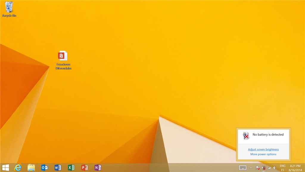

Hi Everyone - The following may help resolve "red X over battery" or "plugged in, not charging".
If your Surface 2 turns off immediately when you remove the power supply the battery may not be detected or will not charge.  The October 14, 2014 update for Surface 2 addresses a case when the battery drains to 0% and will not charge.  Please follow the steps below to apply the latest Windows Updates depending on the scenario you experience:
If you see:
A red X over the battery status icon in the Windows taskbar then use the instructions below:
1. Install the latest Windows Updates, particularly the “System Firmware Update – 10/14/2014” using instructions here.
2. After the Windows Updates are installed Surface should restart.
3. Hovering over the battery status icon in the Windows taskbar should show a status of “plugged in, charging”.
4. Let Surface charge to 50% and then restart Surface (not Shutdown) to complete the installation of the update.
If you see:
A power plug next to the battery status icon in the Windows taskbar, but the battery is not charging.  Hovering over the battery status icon in the Windows taskbar will show a status of “plugged in, not charging”.  Use the instructions below to uninstall the battery and install the latest Windows Updates, particularly the “System Firmware Update – 10/14/2014”:
1. Make sure the power supply is connected and the LED light on the connector is lit.
2. Swipe in from the right, and tap or click Settings. (If you're using a mouse, point to the upper-right corner of the screen, move the mouse pointer down, and then click Settings.)
3. Tap or click Control Panel.
4. Next, do one of the following:
  a.  If Control Panel is set up to show categories, tap or click Hardware and Sound. Then, under Devices and Printers, tap or click Device Manager.
  b.  If Control Panel is set up to show icons, click Device Manager.
5. Tap or click the expansion arrow for the Batteries node.
6. Press and hold (or right-click) on the Microsoft ACPI-Compliant Control Method Battery.
7. Tap or click Uninstall.
8. Install Windows Updates, particularly the “System Firmware Update – 10/14/2014” using the information found here.
9. After the Windows Updates are installed Surface should restart and the battery will be automatically reinstalled.
10. Hovering over the battery status icon in the Windows taskbar should show a status of “plugged in, charging”.
11. Let Surface charge to 50% and then restart Surface (not Shutdown) to complete the installation of the update.

    2014-08-17T00:25:09+00:00
    Ok so I got my Surface 2 and I charged it a bit before using it, so I started it up and accidentally pulled out the charger while it was setting up (I was filling name fields and stuff, no big deal), and it abruptly shut down. I thought it could be that the Surface 2 came with low battery and must be charged more time, so I left it connected, started it up, made an account, and everything went fine except when I saw that both the pre-login screen and my desktop say the device is connected but no battery is charging because, well, it says there´s no battery (0%).
    Yes, I have done my research, but to no avail. All the results are charging problems, but none like mine, at least their Surface 2 detects the battery.
    I would like to know if I need to return it (it was a gift, and I lost my receipt) or if there´s a fix.
    Pic related, it´s my desktop.
