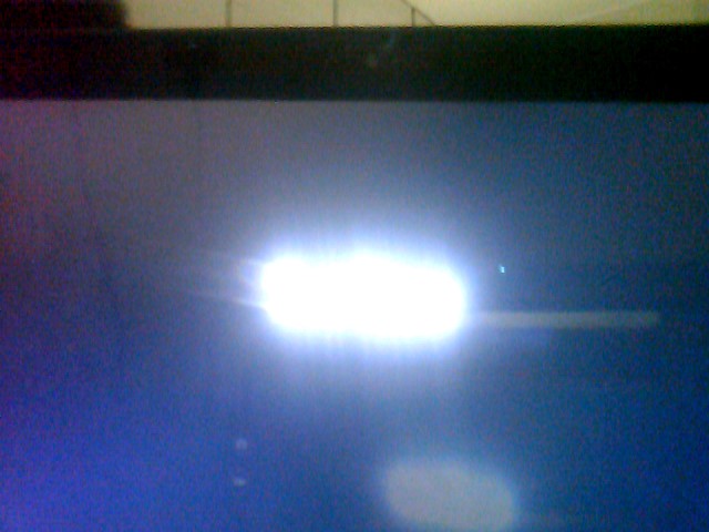

Surface not starting right, now it stuck on black screen "Surface"
2012-12-03T23:19:38+00:00
Surface was frozen during updating last night, had to force shut down. Now it stucks on "Surface"  I can't turn on my Surface. Please help.
