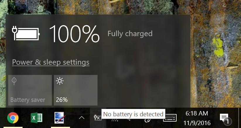

    2016-11-09T11:31:30+00:00
    Well, here's me just piling on I guess.  The update installed, uninterrupted as far as I could tell.  It took several automatic reboots to do so.
    And now, it appears that I have no battery.
    So, what's the next move?
    It's almost a sad form of acceptance, I haven't used my SP3 in weeks, it just sits there with the power cord plugged in doing nothing.  I've been looking at alternatives, like the Yoga, just having trouble justifying the spend.  If this SP3 had a better power connection where a slight movement wouldn't cut the power it could be at the very least usable albeit anchored.
