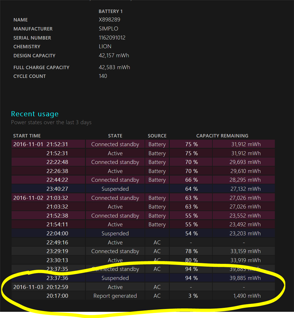

    2016-11-03T13:16:08+00:00
    I encountered two battery sudden deaths already.
    My surface just turned off without any notifications, not even battery saving mode.
    When I hooked the adapter and turned it on again the battery idicator was 0%.
    It is interesting that a update is always installing every time I reboot my surface from the sudden deaths.
    Below is my battery report, one can notice huge battery drops after the reboots.
