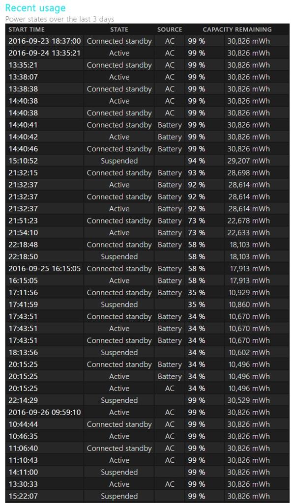

I have a Surface Pro that is a little over 2 years old. About two weeks ago, the battery now reports "Plugged in, not charging" and seems stuck at 60%. I say seemed because if I unplug that AC adapter, it dies instantly. It also will die periodically while on the charger. I have two Microsoft AC adapters and neither of them seem to charge my device.
I've tried all the Microsoft suggestions for this state, but none of them made any difference. Is there a way to diagnose if this is a hardware problem, or is this a new artifact from the latest updates? (My device reports it is up to date.) I never had any battery issues before (lucky, I suppose), and I've treated my surface pretty carefully. I'll be more than disappointed if it's crapped out already.
I'll attach a battery report, but I don't think it tells me anything in particular.
Battery report

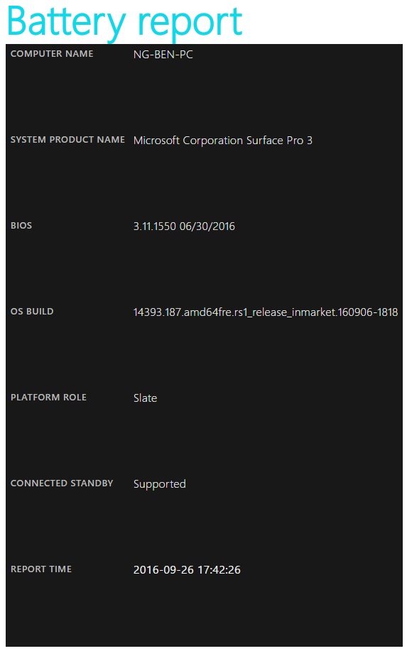

Here is the battery report from today. looks pretty well the same as the one the Microsoft store ran back in August.
Battery report
| COMPUTER NAME | DESKTOP-9T6V95A |
| SYSTEM PRODUCT NAME | Microsoft Corporation Surface Pro 3 |
| BIOS | 3.11.1550 06/30/2016 |
| OS BUILD | 14393.187.amd64fre.rs1_release_inmarket.160906-1818 |
| PLATFORM ROLE | Slate |
| CONNECTED STANDBY | Supported |
| REPORT TIME | 2016-09-26 18:13:51 |

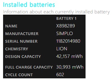

Hi Barb,
I have the exact same problem and symptoms with my Surface Pro 3 which started today morning. My SIMPLO battery will not charge and if I pull the charge cable, it will shutdown completely. It worked fine last night, I cannot understand why is this happening, is hardware or firmware issue? I think it's firmware... Here are the battery details:
