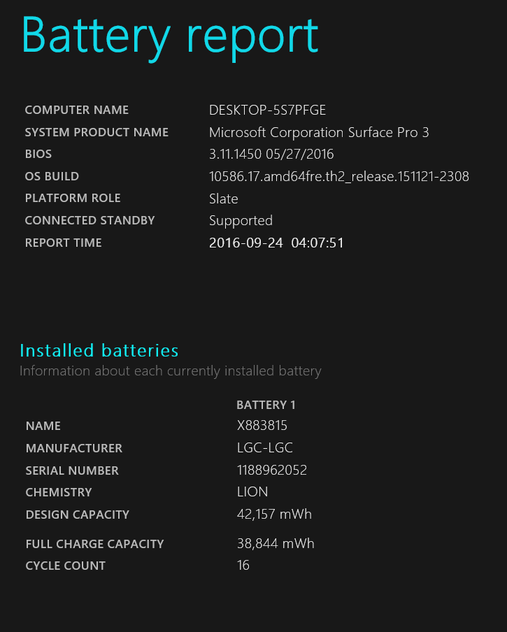

    I have the same issue. I bought surface pro 3 few weeks ago. It was working fine until I updated to firmware 29/08/2016. Since the update my device would not turn on until I plug in the charger and would turn off immediately after I disconnect charger. Battery was stuck at 70% not charging initially which has decreased to 67% not charging now. I have reset my device twice from recovery drive and from within settings as advised by MS support but still no luck. I knew nothing bout SIMPLO/LGC batteries issue. I just came to know about it after reading this thread. Kindly help me out. I have tried almost all the tips advised in threads online. No luck so far.

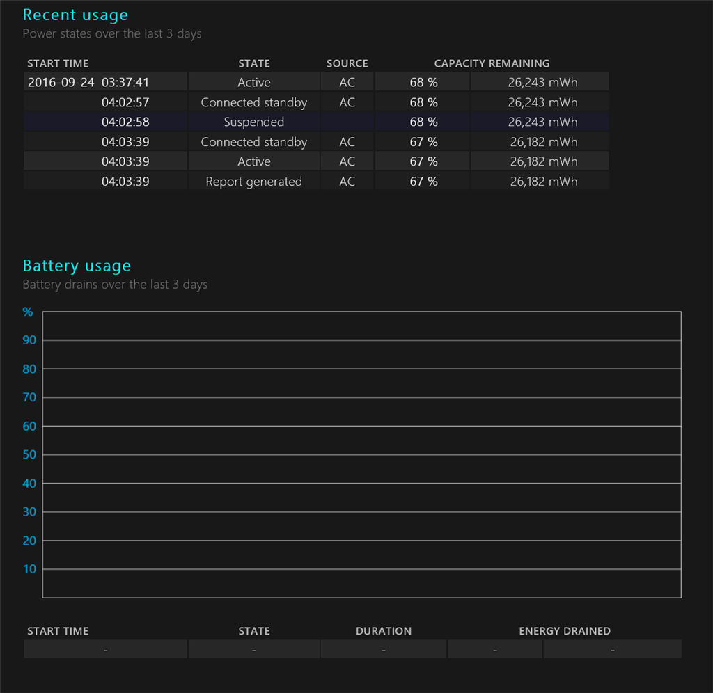

    I also have a Surface Pro 3 with the LGC Battery. Took it to the Microsoft Store this afternoon and was told that the battery was bad. However, the battery report shows that it should still be able to take nearly the full charge. When plugged in, it now says 47%, not charging; last night it quit completely, then re-booted later. After charging all night, the indicator showed 69% charge (confirmed by the battery report), it did work through the school day today.
    Is there a fix in process? Problem seems to have begun after the 8/29 update......
