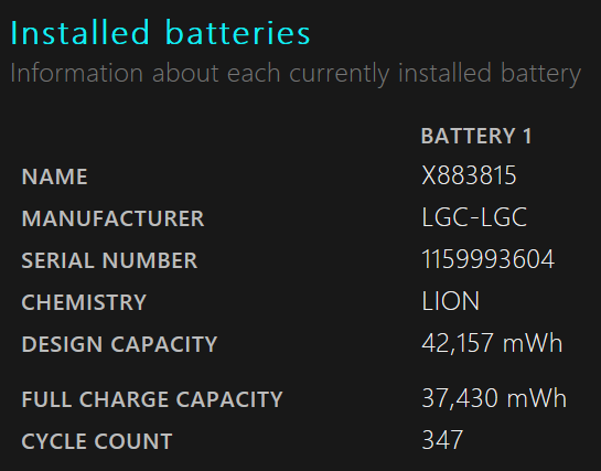

    My lgc battery is at 2 cycles no battery present 100% charged. Dies immediately when unplugged. Nice 900 dollar paperweight
    Yeah its frustrating to say the least. 2 Cycles?  Is this just out of the box Surface Pro 3?  What is your full charge battery capacity?  My cycle count was 177 yesterday, it is at 199 today after one full discharge/recharge.

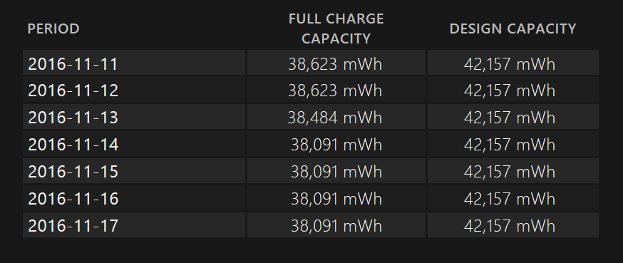

    I'm back too again. Although technically mine was fixed with the firmware update, I'm not sure if it was fully fixed. I've been working on it for exactly a week now and i'm noticing something odd. So my battery went from recognizing only 5000 mWh to now 39,000 mWh but each time I use this during the day and charge in the evening, I noticed a couple of hundred mWh is unusable. so in this past week, I went from 39000mWh down to 38000 mWh and seems to progressively get lower each day I use it. Any thoughts? Oh and I forgot to mention my cycle count is currently at 436. Yeah, I use it a lot.

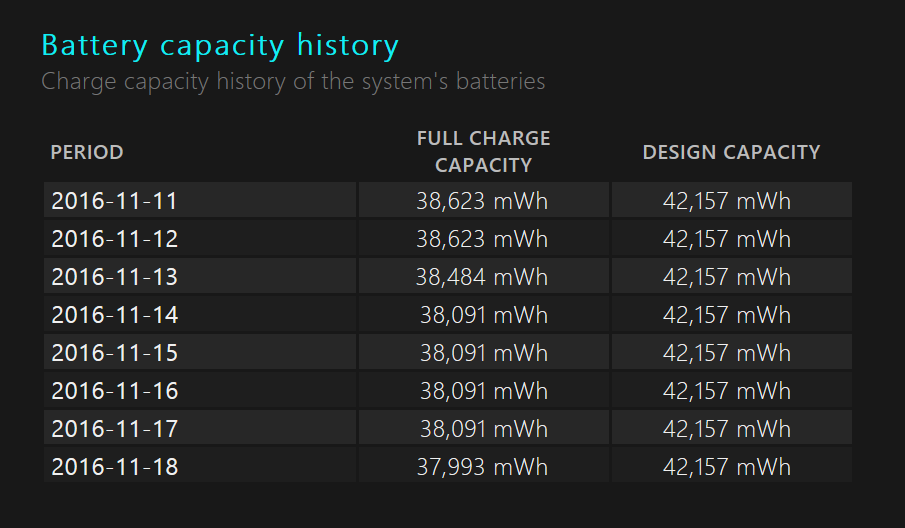

    I am in the same situation on a fresh install. Every since the new update I have been seeing inflated charge counts and loosing a few mWh per charge. Very troubling for such an expensive device. At some point MS needs to just face the music and fix users devices. I was seriously considering upping to the next Pro or a Surface Book but this has me concerned. It is not like a regular laptop where you can just buy a new battery. I have devices that are older, but little to no battery degradation.
    After a burning it until shutdown today and giving it a 5hr charge, it dropped to 37,688 for today (not pictured 11/18)....sigh
