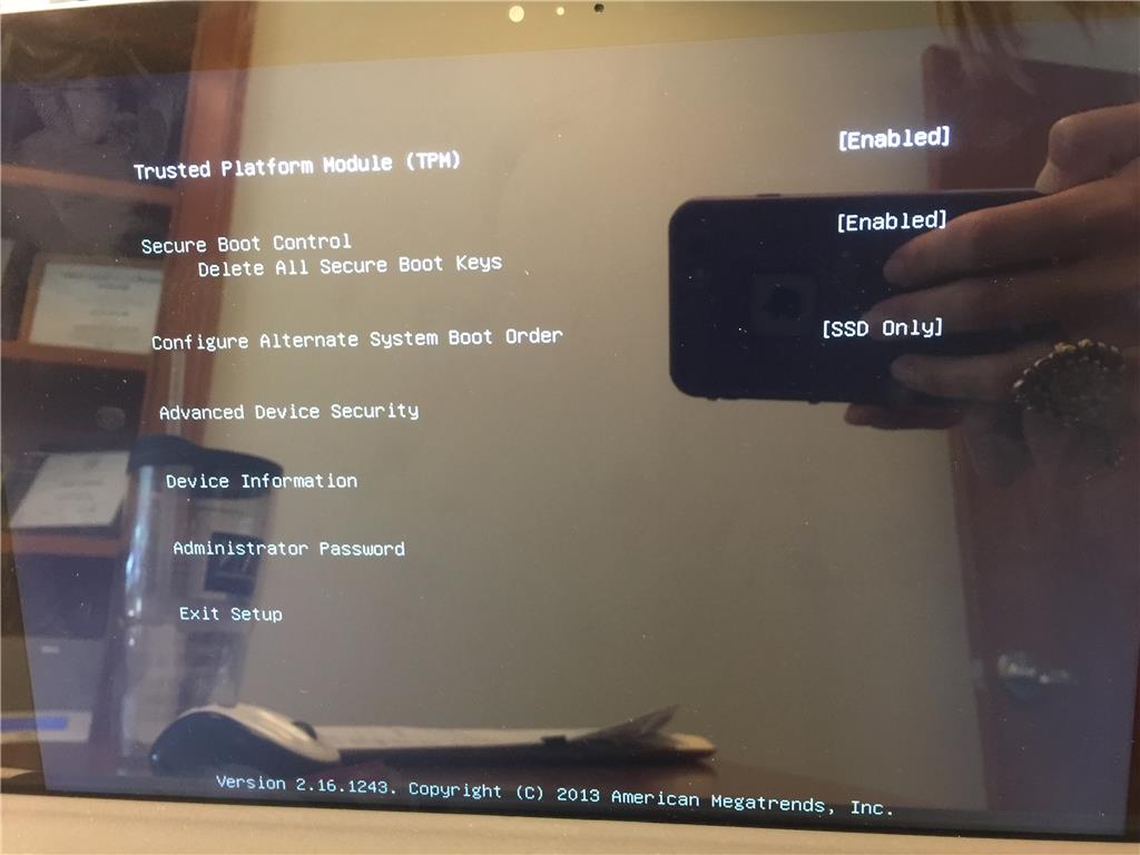

It was suggested that I open a new thread for this issue that I am having.
Since the Win 10 Anniversary update, I was not able to turn on my Surface Pro 3 i7 512GB with LGC LGC Battery without having it plugged in with the power supply or docking (I own a total of Three Surface Pro 3 Docks at home and 2 offices). It always said "82%, Plugged in, Not Charging", and would always instantly turn off once I pulled off the power supply tab.
I had spoke with a Technical Agent online, had my Pro 3 remote accessed, did all the proposed solutions, and even had a call from Bellevue, WA (I live in Hong Kong) before I found out that it was a software issue as stated by Microsoft.
With Auto Update turned on, I was notified that I should restart my Pro 3 this morning while I was on the docking station. I was happy that this issue was going to be resolved, but now I am disappointed that this firmware update did nothing for my Pro 3.
I'm hoping that someone out there has some suggestions.
Thank You.

    Anyone else getting the black "Trusted Platform Module" startup screen as well? I'm getting it randomly on reboot, it won't respond, can't exit out, but if hold down power button, I can eventually get it to boot up (plugged in of course). This one has the LG battery, surprisingly - seems most others are having problems with the other battery. I pasted the entire battery report below. It looks like something happened October 3rd? I'm going to go back through all the logs & updates to see if I can find anything from that date.

    Yes, This happens to my surface as well (Also LG battery that is not charging).
    This is why I indicated that this is a FW/BIOS issue. No OS will fix this issue. You can try installing windows 8, 8 .1 ,7, XP, 3.1, DOS, or even OS X/Ubuntu, but this will not address the issue.
    Whatever changes were made in the FW update to fix the Simplo battery issues within the Aug 29th update is what caused this issue.
    If we were able to rollback our FW via a BIOS flash, we can confirm if this fixes the issue.
    I can volunteer my device if you would like to test this out.
