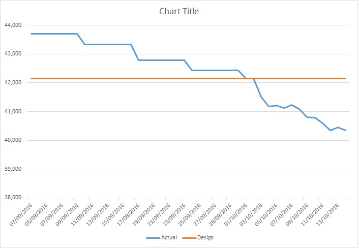

    The second SP3 has been thus far okay. Runs for hours on battery. No reliability issues at all. However the battery report tells another story. I extracted the battery capacity history data and put it on a graph:
    (NB: the sudden steps between 3 Sep - 3 Oct are because the battery report gives a weekly average rather than a day-by-day for old data)
    What this says is that it is quietly losing about 2Wh of battery capacity a month. This means that after about 8 months I will be down to 50% of the original capacity and after 14 months down to 10%.
    Sadly I didn't start looking at the battery report until recently so I can't pinpoint when the degradation started but it MUST have been in the last month or two because as you can see this time last month my battery was reporting 1.5Wh ABOVE the design capacity.
    So I suppose what I'm saying in summary is that even SP3s that appear to be healthy may not be and whatever happened in the past couple of months could have put a death sentence on all SP3s.
