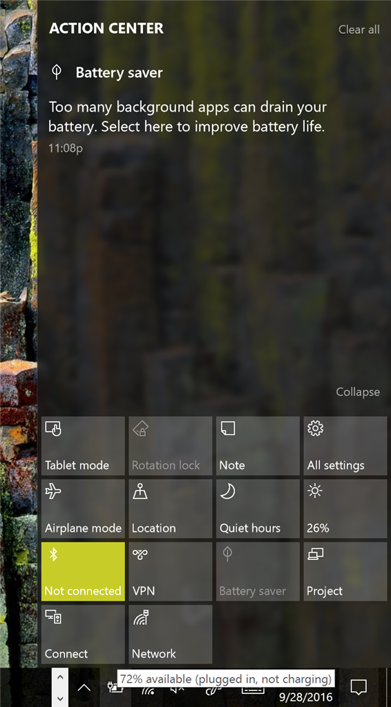

Since the Win 10 Anniversary update, I was not able to turn on my Surface Pro 3 i7 512GB with LGC LGC Battery without having it plugged in with the power supply or docking (I own a total of Three Surface Pro 3 Docks at home and 2 offices). It always said "82%, Plugged in, Not Charging", and would always instantly turn off once I pulled off the power supply tab.

    <EDIT> I should mention that the "Select here" did not solve my issue and improve battery life</EDIT>
