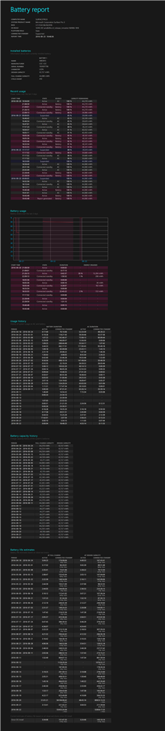

    2 hr 19 mins from a full charge... and this is if the device is doing nothing.  It's RIDICULOUS!!!!
    And in just producing this report (Sorry the length caused an error when clicking submit so I cheated and used an image to get around it. :D) the battery level is already down to: 87% 1 hr 31 min remaining... Not really very usable.  I normally make heavy use of Visual Studio and VMware and I absolutely MUST leave the thing plugged in.  I do consider myself luck in that it doesn't just shut off as soon as it's unplugged though.
    Here is my battery report...
