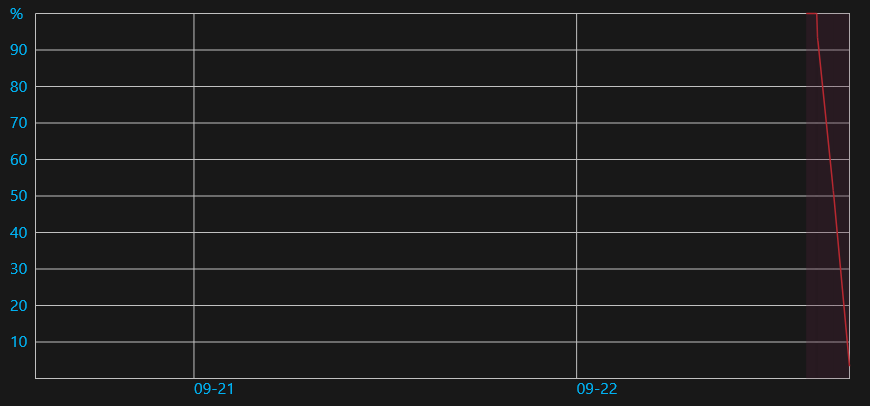

    Hello from France !
    I'm working at the IT department for a company, and Surface Pro 3 users have issues with LGC batteries (fast draining).
    Battery report of an impacted user :
    SYSTEM PRODUCT NAME Microsoft Corporation Surface Pro 3
    BIOS 3.11.1550 06/30/2016
    OS BUILD 14393.187.amd64fre.rs1_release_inmarket.160906-1818
    PLATFORM ROLE Slate
    CONNECTED STANDBY Supported
    REPORT TIME 2016-09-23 14:03:41
    Installed batteries
    Information about each currently installed battery
    NAME X883815
    MANUFACTURER LGC-LGC
    SERIAL NUMBER 1185619460
    CHEMISTRY LION
    DESIGN CAPACITY mWh
    FULL CHARGE CAPACITY mWh
    CYCLE COUNT 42
    Recent usage
    Power states over the last 3 days
    2016-09-20 14:04:00 Active AC 100 % mWh
    19:38:43 Connected standby AC 100 % mWh
    19:38:44 Suspended 100 % mWh
    2016-09-21 09:07:18 Connected standby AC 100 % mWh
    09:07:18 Active AC 100 % mWh
    09:11:52 Active AC 100 % mWh
    19:57:35 Connected standby AC 100 % mWh
    19:59:17 Active AC 100 % mWh
    20:00:04 Connected standby AC 100 % mWh
    20:00:05 Active AC 100 % mWh
    20:00:50 Connected standby AC 100 % mWh
    20:01:17 Suspended 100 % mWh
    2016-09-22 09:06:58 Connected standby AC 100 % mWh
    09:06:58 Active AC 100 % mWh
    14:23:28 Connected standby AC 100 % mWh
    14:23:52 Active AC 100 % mWh
    15:00:07 Active Battery 100 % mWh
    15:03:39 Connected standby Battery 100 % mWh
    15:03:45 Active Battery 100 % mWh
    17:06:52 Connected standby Battery 3 % mWh
    17:06:53 Suspended 3 % mWh
    17:27:00 Active AC 5 % mWh
    17:55:06 Connected standby AC 11 % mWh
    17:55:07 Suspended 11 % mWh
    2016-09-23 09:04:52 Connected standby AC 11 % mWh
    09:04:52 Active AC 11 % mWh
    14:01:44 Report generated AC 97 % mWh
