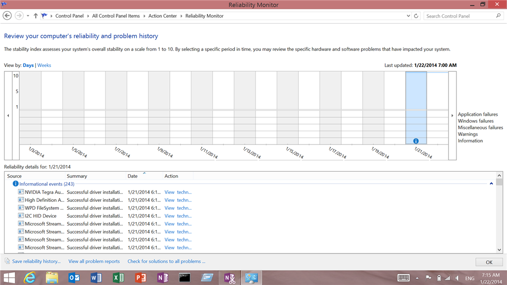

    2014-01-22T12:21:31+00:00

    ran the bat file as admin, then checked windows update..restarted...all the drivers where installed. :)
    worked great for me. I reset using the internal restore not usb.

    After 8 hours in standby and 12 hours after the refresh my reliability report looks like I never have seen it in my S2.
