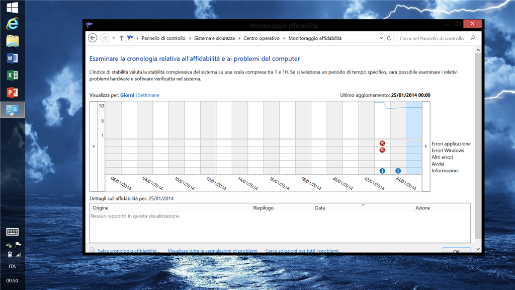

    Here's my Reliability Report before and after the patch (and quickfix):
    Before: Skype crash + Display drivers crash during sleep -> After: No problems at all.
    VERY nice... :)
