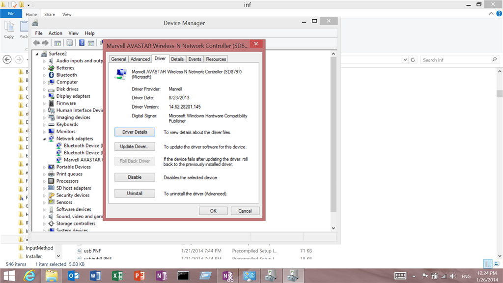

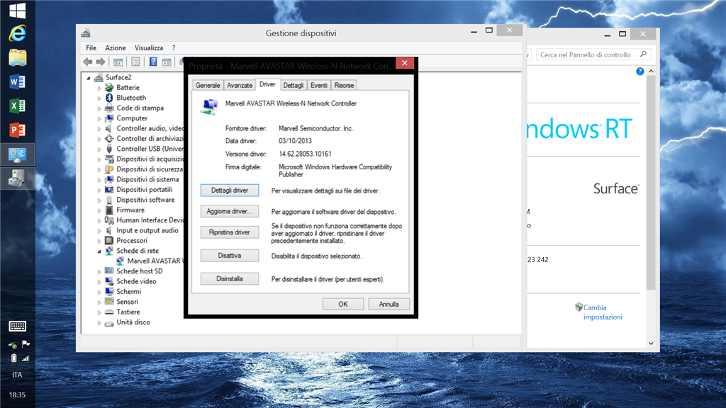

    Paolo, could you check the WiFi driver, it seems that was not updated. There is a new driver that is not installed.
    My version is up to date:
    2014-01-26T17:26:04+00:00
