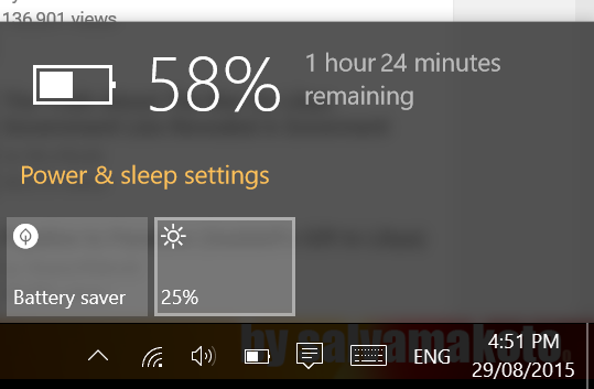

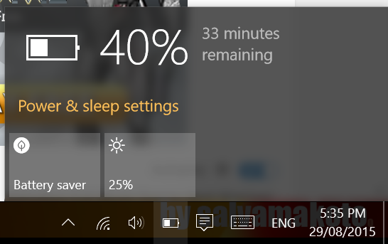

    The problem seems to be the power requirements of the screen, Surface and charging are not covered by the restrictive USB power supply.
    The quick fix when the battery is low is to dim the scream before plugging in the charger which enables charging.
    You can increase the brightness a little until the battery comes up the charge current tails off then you can use as normal.
    Also remember to dim the keyboard back light.
