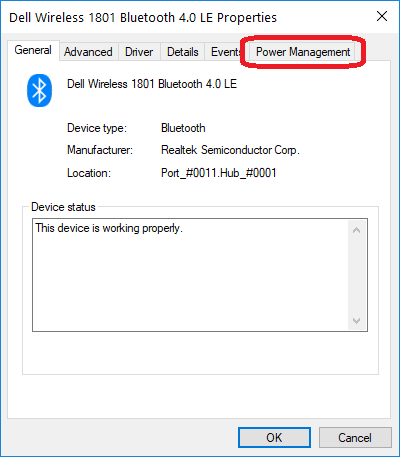

    Then access the driver properties (right button > Properties).
    The evidence to know if the chosen driver is the main bluetooth driver is that the properties window has a "Power Management" tab:

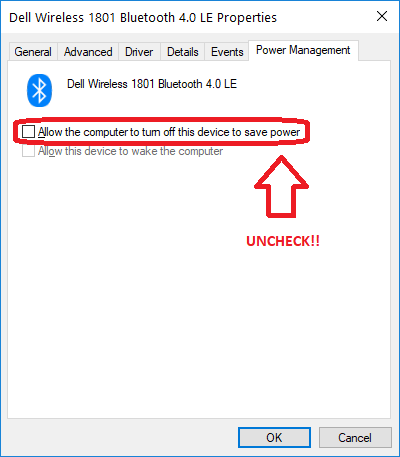

    Then go to this tab and UNCHECK the option: "Allow the computer to turn off this device to save power":
    Click in "Ok" and be happy! I tried a lot of things, and only this worked for me!!

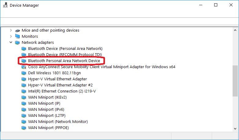

    I disabled this option too in an other driver that I find (see below), but I dont know if it needs to solve the problem.

    2019-08-08T16:00:52+00:00
    I think we all have tried that, hence the thread.  We are having problems with the Marvel Bluetooth radio on the Surface 2 with the surface keyboard.  Though, since the last update KB4505903, I can't say the Marvel is having problems anymore.  I think it went away.  Will know soon.
