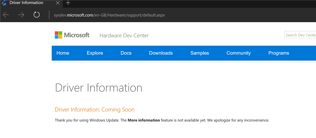

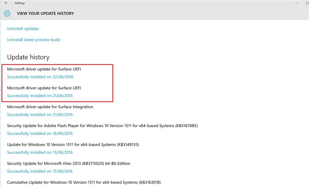

    Anyone notice 2 UEFI updates, first on the 21st and another today ??
    Also no published information ... useful !
