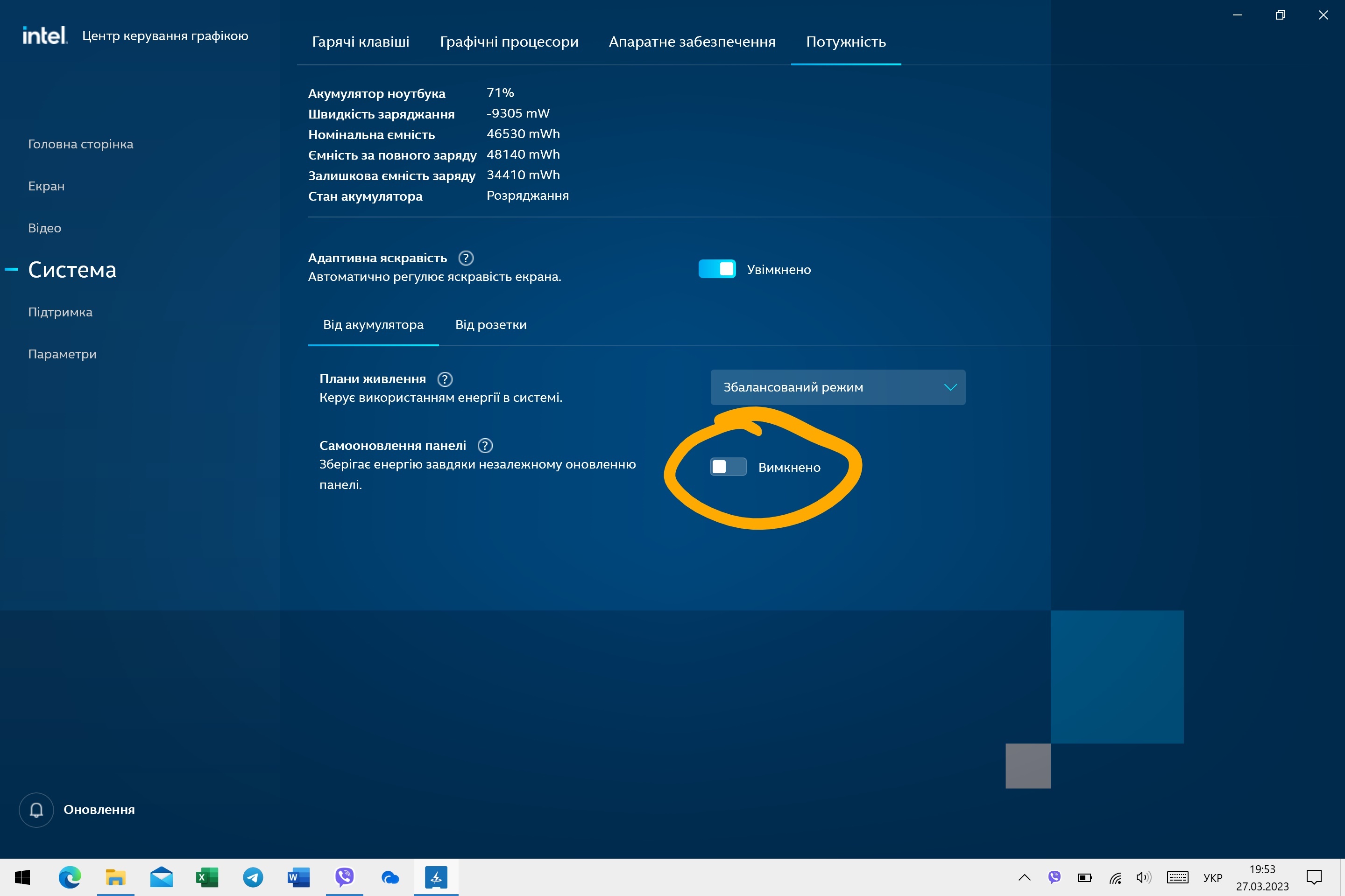

    I think I found the reason why it flickers
    Windows 10, it works.
    in the intel graphics control center option option Panel Self Refresh disable/ It works for me no flickering for a week.Image
    I notice same issue with my Surface PRO 9, but screen was flickering only on battery power. When I put surface on power supply flickering gone.
    After updating drivers and reading this thread disabling self-refresh display seems to be ok now also on battery power. So probably MS needs to talk with Intel here to properly make drivers for this device.
