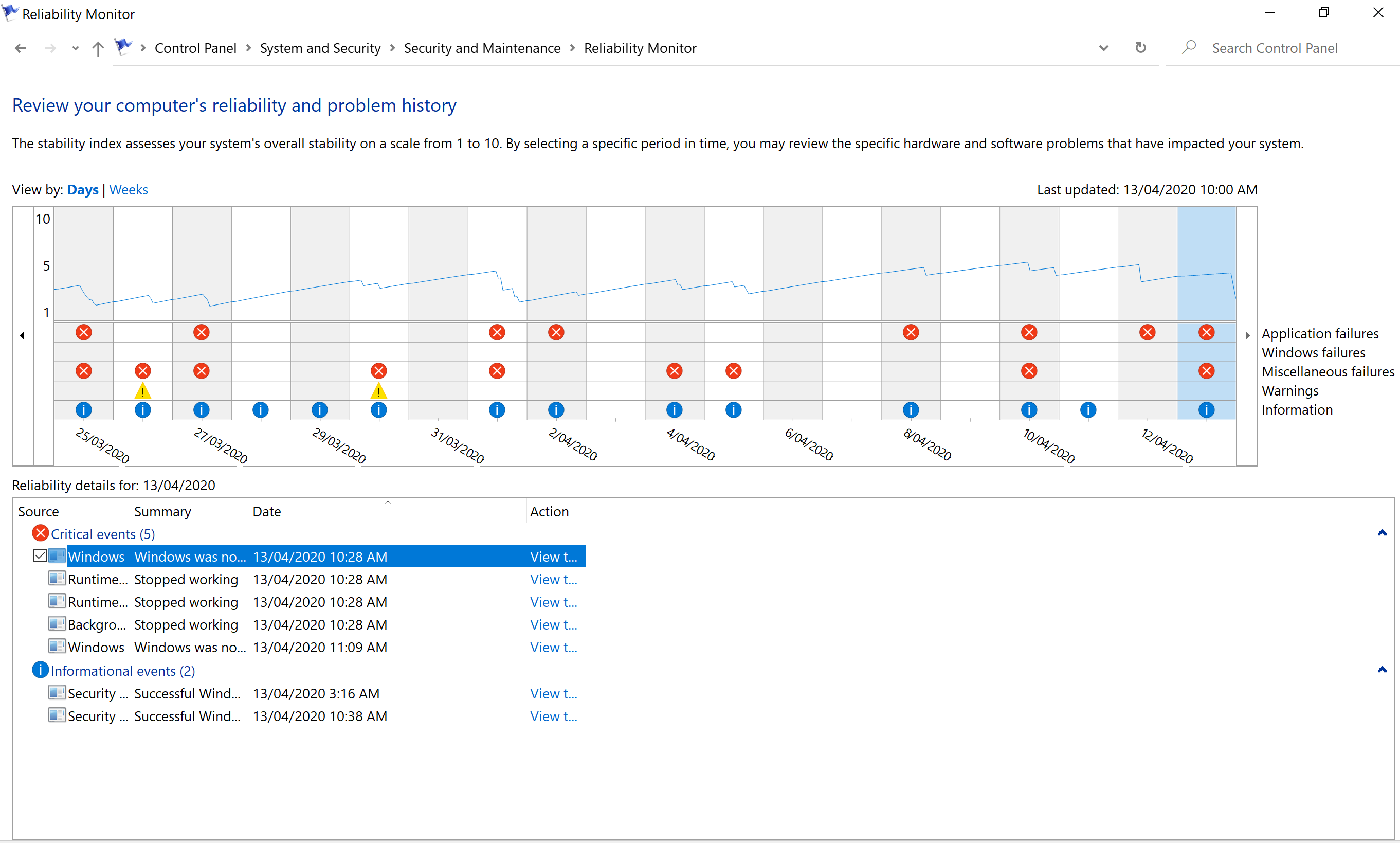

    2020-04-18T14:47:25+00:00
    Try Device manager-> System Device -> Intel Management Engine Interface -> Power Management tab, uncheck "allow the computer to turn off this device...." Let me know if this work.

    2020-04-18T15:16:13+00:00
    Awesome idea with posting these options every so often to make it easier for those experiencing the issue. I myself used option 1 which i did back in mid February. Haven't had a problem since. My wife is now using the surface for 10 straight hours a day while she's working from home and still no issues. I dare not screw things up so I'll just leave it like this until there's an issue if one ever comes up, but what are the down sides of this option? I haven't been inconvenienced with any that i know of. Also, this Surface 7 Pro issue and this forum are getting noticed and mentions in tech website articles. The more pressure that's put on MS to fix it with an official remedy, the quicker it'll happen i think. Thanks again for the post.
    Excellent, thanks for the update.  I haven't experienced any downsides to Option 4 either.  In fact, I forget the Intel Graphics Command Center is even on my system now.  It was a 1-time settings adjustment and that did the trick.  Keep us updated.
    Yeah I've seen more and more articles popping up in the last few days about this issue!
    2020-04-18T15:16:37+00:00
    Ok... some updates here.  I've decided to try reinstalling windows as advised by Microsoft support. It's quite a troublesome thing because U need to back up your files and boot your surface.  After reinstalling, I've tried downloading the Intel Graphic Command Center and off the  panel self refresh for both on battery and plugged in, as suggested by comments 👍�� Seems to be working fine for now.  Will update if i have any shutdown or crashing issues again. 😊
    That's great!  Option 4 is what did the trick for me too.  Keep us updated.
