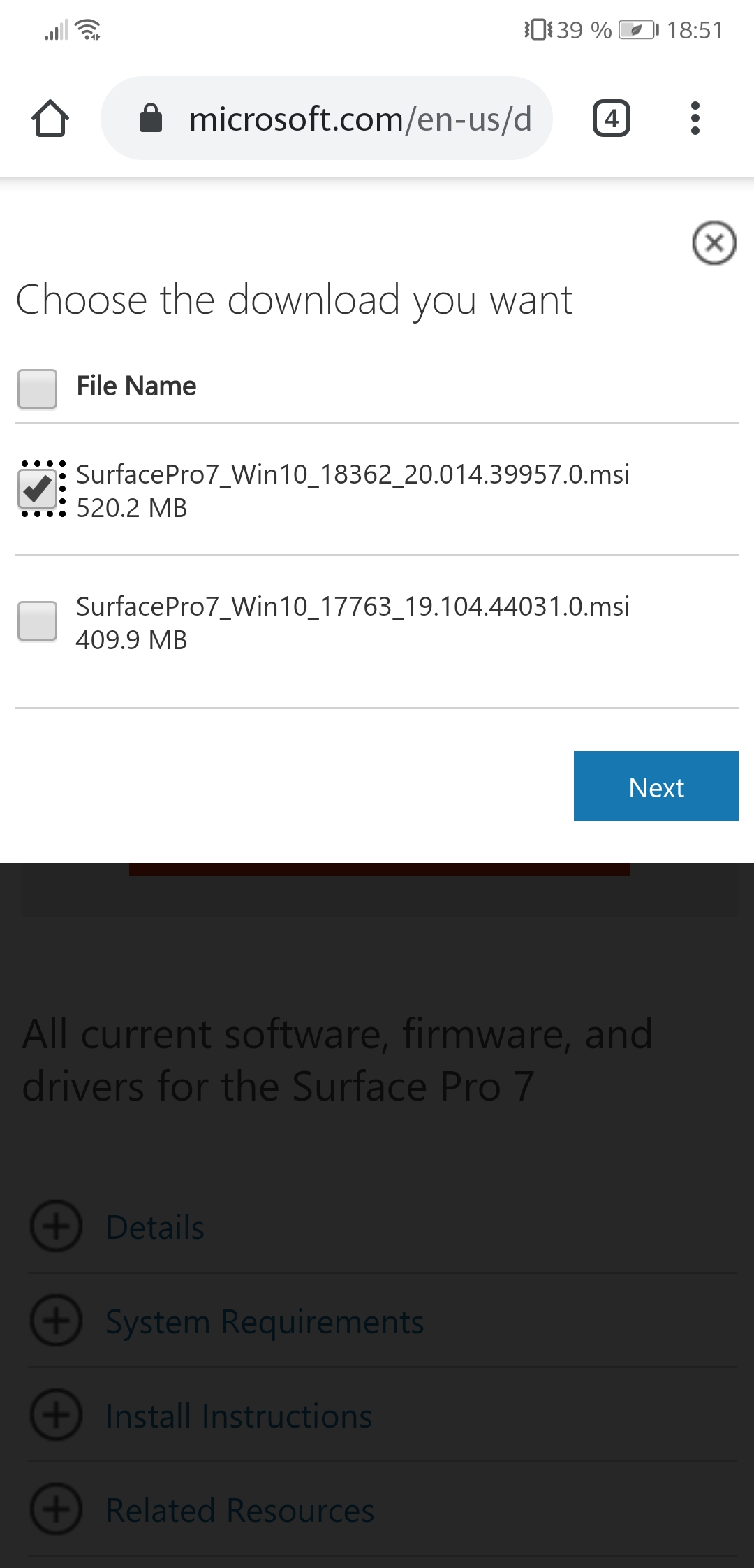

    which exact firmware update fixed this (check settings, updates, view history)?
    I got the updates from here:
    https://www.microsoft.com/en-us/download/details.aspx?id=100419
    When you click on DOWNLOAD, there are 2 files.  I downloaded both and installed both.  Ironically, my Surface
    shutdown in the middle of one of the installs, but I powered back on and had to uninstall the update (I guess it
    installed some of the update)  then reinstalled it.  Like I said, I'm still holding my breath and hoping it's a fix.

    Hello Barb, I downloaded and installed the checked Version of the firmware Update from the Microsoft Page.

    So I installed the firmware in the picture above that was the 520 mb version.  When that one was installed, the other one I had also downloaded that's about 410 mb said that there was a newer version already installed (presumably the 520 mb file), so it didn't install the 410 mb version of the firmware.  Fine.
