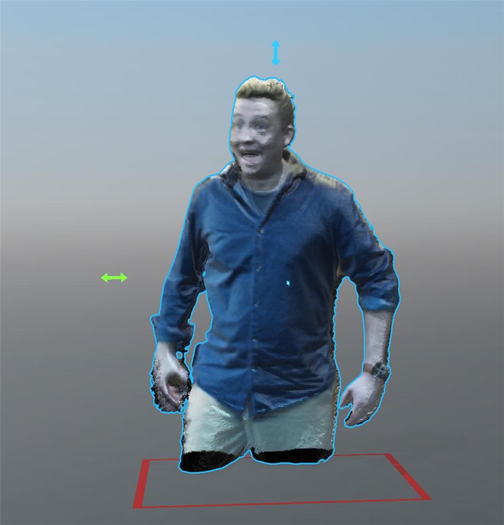

    attached is a 3d model made from Kinect on surface book from February...   #SAVEKINECT
