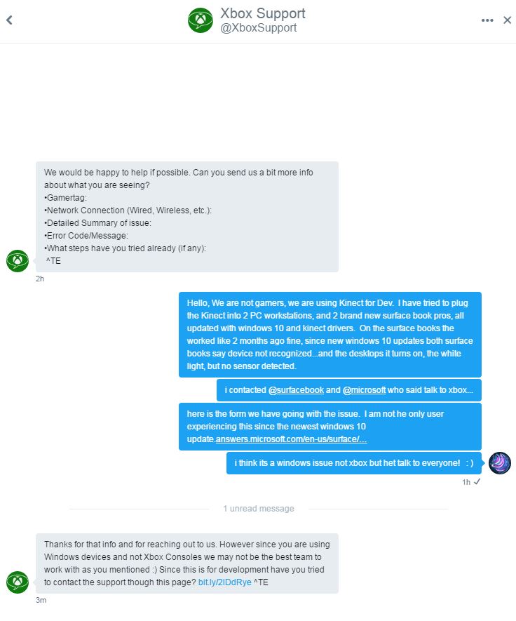

    twitter support to all parties involved was no help at all...  @windowssupport was the least responsive...  : (

    Well i tried,  The steps did not work for me....  : (  no matter what i do it says USB device not recognized and the beeping that won't stop.
    I am banging my head on the desk.
