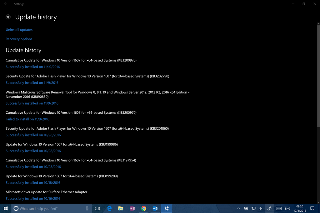

    Yea, as described earlier, replacing the battery, pen or Surface didn't help.
    The double-click-pen-issues only started after the firmware update that came with the anniversary update. They also updated the touch firmware with that one. When I got my replacement Surface last year, it still had the old firmware and no pen-issues. Only after updating did it occur again.
    Maybe we will see a new touch firmware with the creators update, but since Microsoft hasn't even acknowledged this issue I wouldn't get my hopes up.
