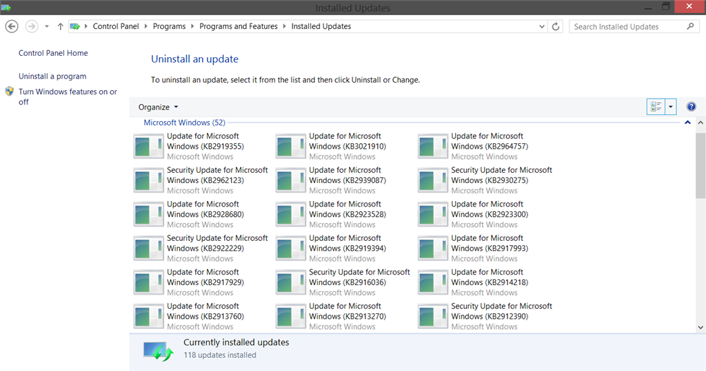

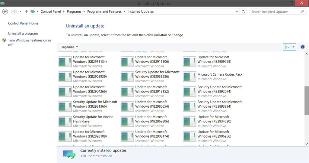

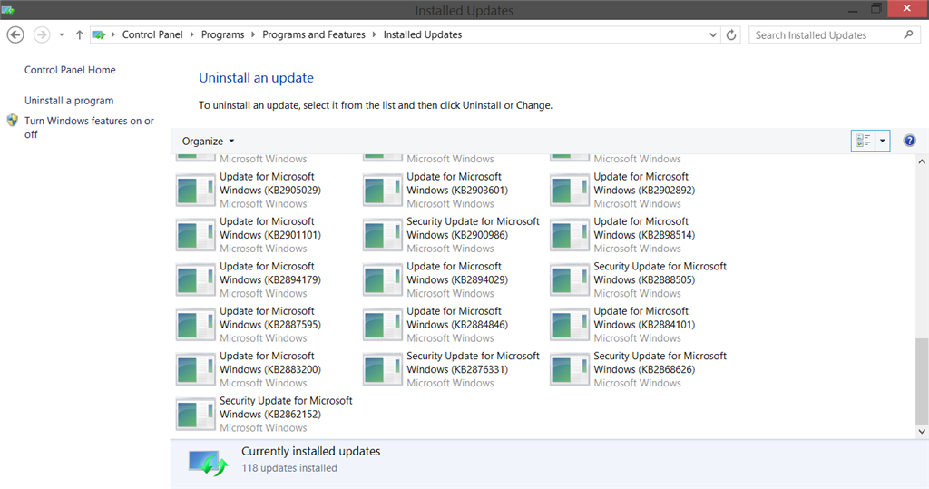

                 the list of updates that it has installed so far.
    Looks like you are stalled at KB2919355.  E.g. in particular no message at the top indicating the "Most recent cumulative update".   I had been guessing that that one might have caused that change but I suppose it could have been just KB3000850.  FWIW I don't understand the difference between  KB3000850 and the latest "Rollup" and am surprised to still see KB3000850 listed as the "Most recent cumulative update", although I think it is the only one that I installed as an Optional update.  Maybe that's all it means.
    Please try the IE method of finding out what version of it that you have active.
    Also, please go from the History back to the Windows Update main page and use its buttons to see if you have any Optional updates.  Right now I don't because the Preview ones which were optional last month have now been applied as December "Rollup" updates.  Presumably there may be another optional preview one later.
    HTH
    Robert

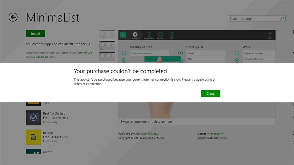

    ok now i have tried an experiment i reset my surface once again just to see what happens i was able to install several apps from the store and i could access my account on the store i have not installed one update yet now this tells me that there is one or more updates that is causing this problem with people not being able to install apps from the store or download and install updates so i think Microsoft needs to research this and find out what the problem is witch updates or updates are causing this problem and fix it because from what im reading this problem is not just happening on the Rt tablet but all of them so now the ball is in Microsoft court .
