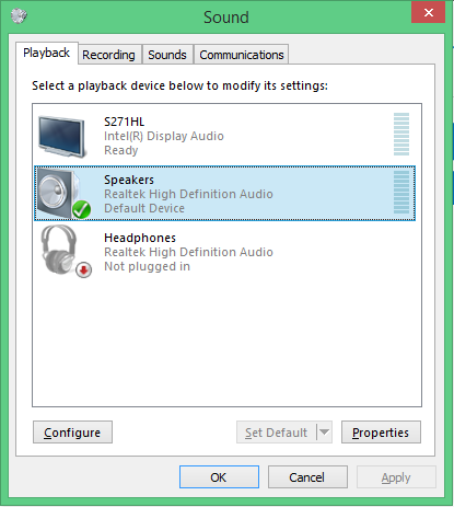

    This is what worked for me;
    1. Go to Control Panel
    2. Click the "Sound" icon to access sound settings
    3. Select your Surface Pro built in speakers, mine are (Realtek High Definition Audio, Default Device)
    4. In the options below select "Set Default"
    5. Click ok, or click Apply and then OK.
    This is how it should look, the S271HL is the driver sending audio to my HDMI monitor, which does not have speakers.
    The Realtek High Definition Audio is my surface built in speakers, I defaulted to that.
    Test to see if its already working, if not do the following
    Click the speaker icon in the bottom right and then click Mixer. There will be a column for Device with a drop down menu below it. Click that and choose the other sound ouput device.
    Test and see if it works.
