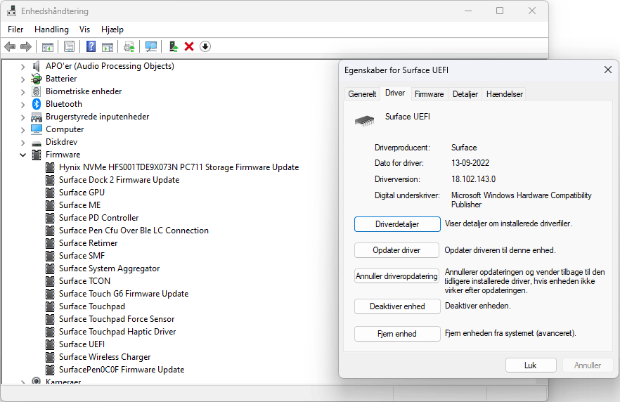

    During my current battery drain issue, I researched how to solve a battery issue on a Surface-based laptop and found a few good ideas. One of the ideas was to remove the battery device from the Device Manager. To complete this, I went into the device manager and removed the "Surface Battery" driver under the "Batteries" tree item. Once I removed the Surface Battery device and rebooted my laptop the charging problem disappeared.

    The supervisor was incredibly helpful and understanding, and she asked me to open Quick Assist on my computer so she could access it remotely. As soon as she entered my computer she went to "Device Manager", and next to "Surface UEFI" there was an explanation mark in a triangle. This was apparently preventing full windows updates from being possible, so she had to manually download something to my computer (I'm sorry, I don't know what it was..) and THEN I was able to update windows, and THEN the explanation mark symbol was gone... it seems to be working normally now, I've been testing the battery all weekend. Plugging it in at random percentages to see if I could replicate what had been happening and I really think it's fixed now.
