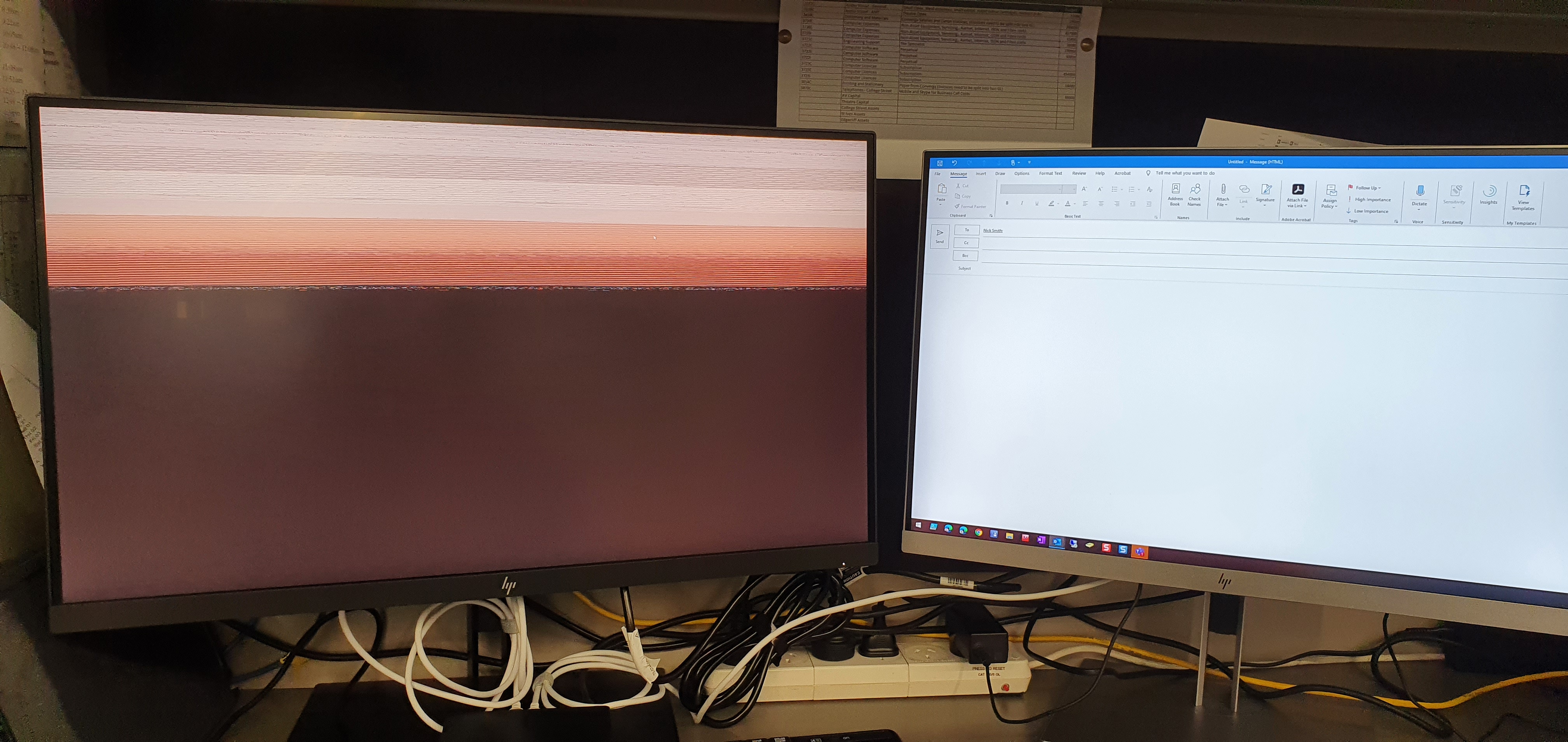

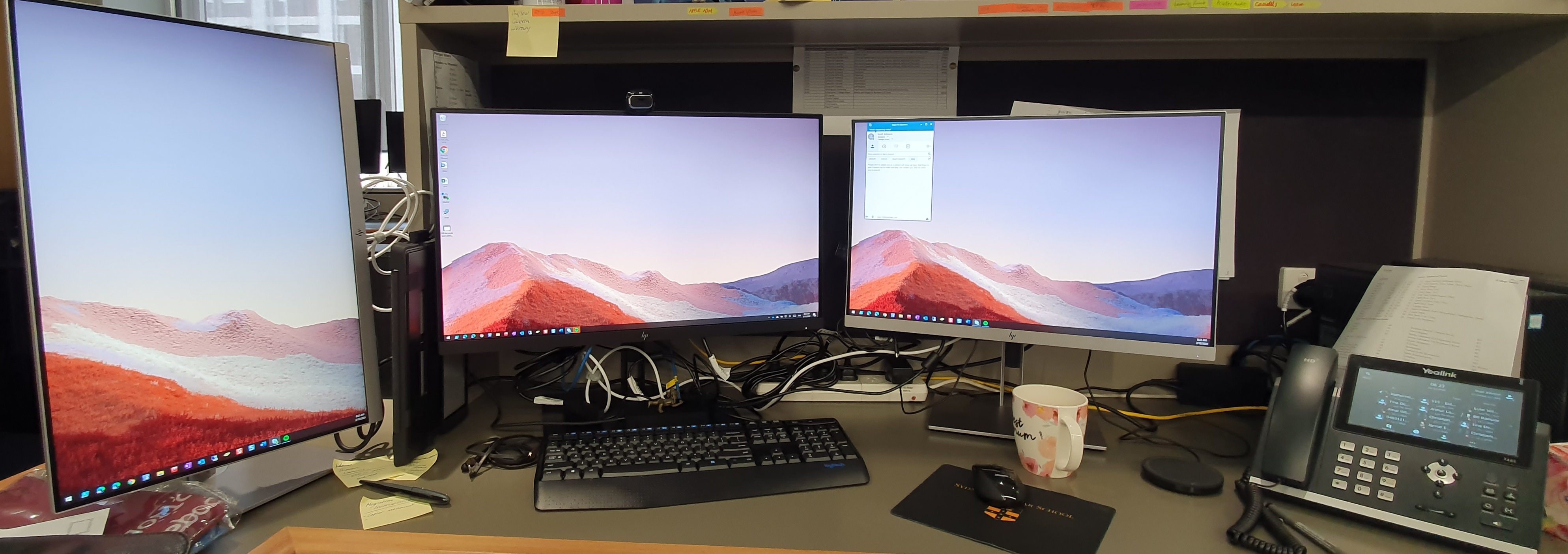

    Finally found the solution to my issues with Surface Pro 7, Dock 2 and three monitors.
    I tried two ACTIVE USBC-Displayport MOSHI cables - they were even worse. Flickering and turning black every few seconds. A reboot fixed it but kept coming back.
    Yesterday I received two Microsoft USBC-HDMI adapters. $65 each.
    As soon as I plugged one in, everything started working.
    2 Days now and multiple reboots and unplugging of dock and everything works a treat.
    From this
    To this (the screen on the left is a 24" portrait - camera stretched it)
