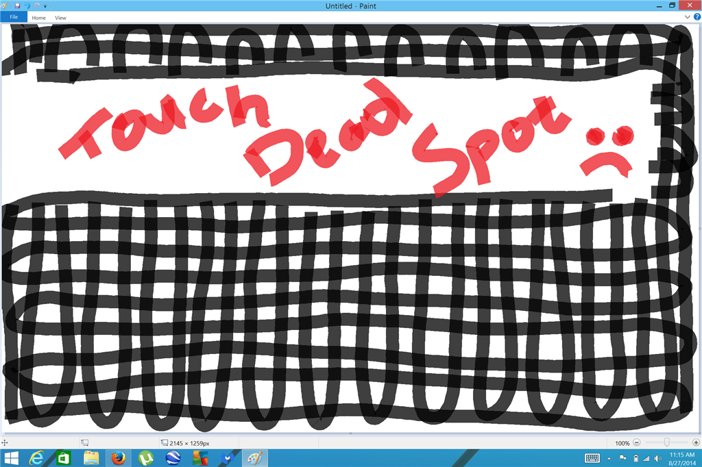

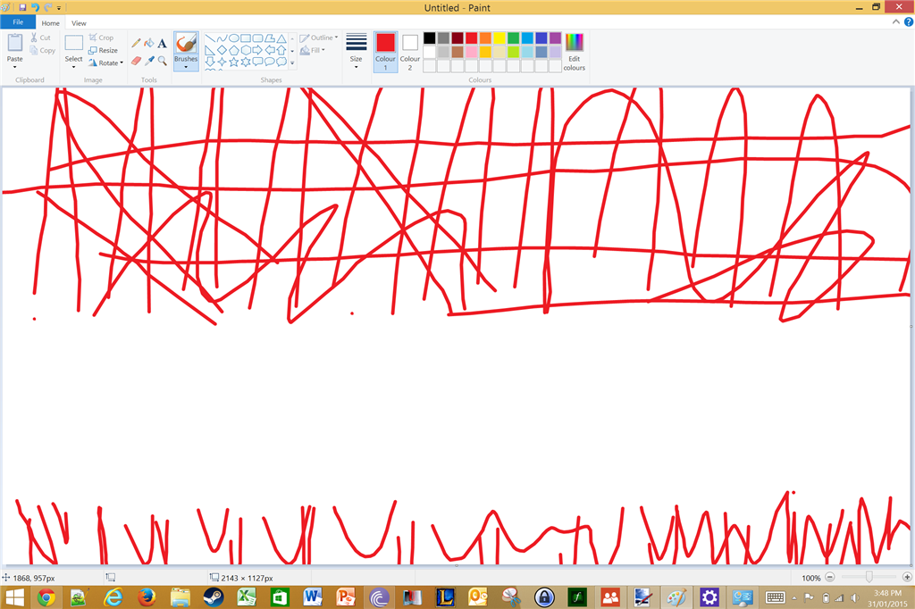

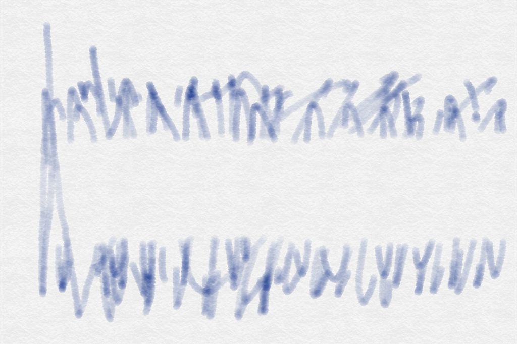

I recently purchased a surface pro 3 that I have run into a problem with. Pen and touch are not functioning within a half inch stripe on the screen, going from a little right of the camera to the bottom of the screen. Whenever I draw with touch in one note, there is a blank space between the two sides of the dead spot. When I use the pen, the digitizer incorrectly senses the location of the pen, and the resulting writing/drawing is not correct, but still connected. I have linked an image of examples here. I have tried restarting and going through windows updates, but it has not been resolved. I am beginning to think that it is a manufacturing defect, because it is less than a week old.
Thanks
Open the control panel and look for TabletPC Settings, Reset and then calibrate.

    Less than a week and I am also doomed to such a shortcoming of a system's consistency and usability such as this 'touch deadzone'. And like the original poster, I am also a user who has since been diverted away from the windows scene for a long time (5 years since my last windows based laptop) and have reignited hope for a brighter future to return to my roots.... Nay. I am reluctant to share my dismays but this is just disheartening. And don't tell me to go through that 6 steps troubleshoot when upon failing to remedy the situation using the first few steps and then seeing the last few steps were merely a complete restoration into factory settings in its essence. Big upside-down smiley face indeed.
