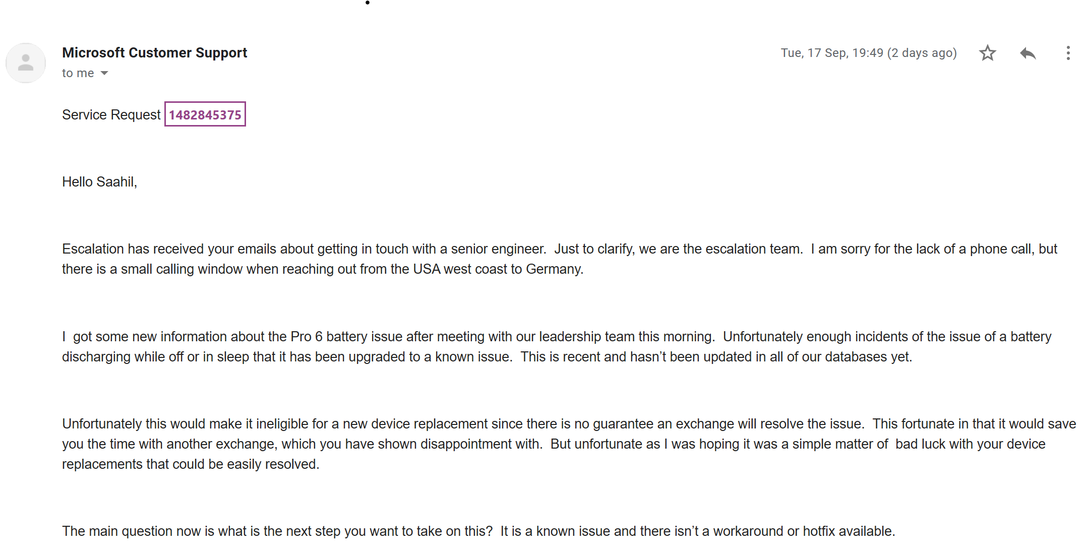

    This is crazy. A possible "fix" being released vs. the escalation team having just acknowledged the issue as Barb Bowman said...
    So is this good or bad news? I can't even tell anymore.
