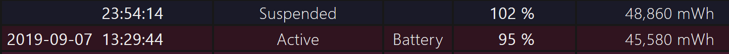

Lately, after I shutdown (full shutdown, not sleep or hibernate) my fully charged Surface Laptop 2 at night, I turn it on in the morning and find that the battery has lost around 25% power overnight! What's going on and how can I fix this?
The laptop is only about 6 months old and the battery seems to be in good health.
