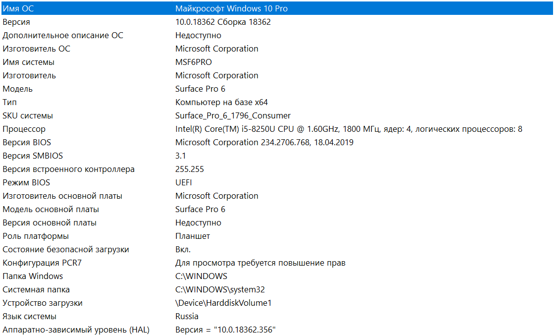

    2019-09-22T07:10:52+00:00
    I uninstalled them and realized there was the box to cancel the drivers after having pressed ok... redid it just in case
    Btw after posting the first post I did some playing with Geforce Now and right now (1 hour I guess?) i'm at 89%
    So seems all good an fine
    2019-09-22T06:48:14+00:00
    Why did you uninstall the drivers again? How did you cancel?
