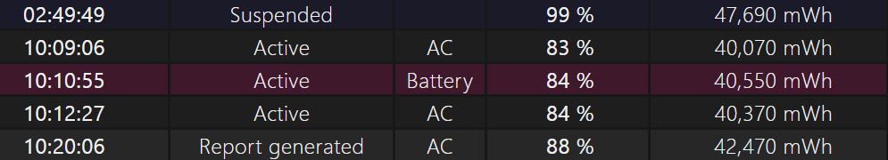

    I just started my PC after its first overnight shutdown after installing the 1909 build and I'm sorry to say that there is still something odd that occurred.
    My battery indicator showed that my PC started up with 85% power rather than a full charge... However, a batter report shows that no charge was lost. This is the first time I've seen the report and the indicator contradict each other. Currently, my PC is apparently recharging from 85%, although the battery report says it was at 99% to begin with.
    *UPDATE*
    Newly generated battery report now contradicts the previous one!
