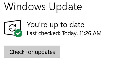

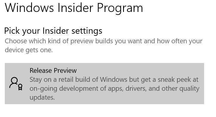

    I rejoined the release preview, restarted a few times, no further updates appear to be available.
    Just to be sure, I did the same, but no extra firmware updates for me (Laptopo 2).

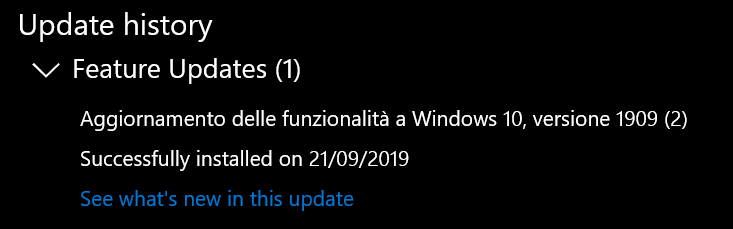

    I have only this
    And I still confirm the battery issue is gone and the dawning is good and steady, so for me the issue is fixed

    1909 isn't necessary. 1903 should be enough from what I and others have experienced.
