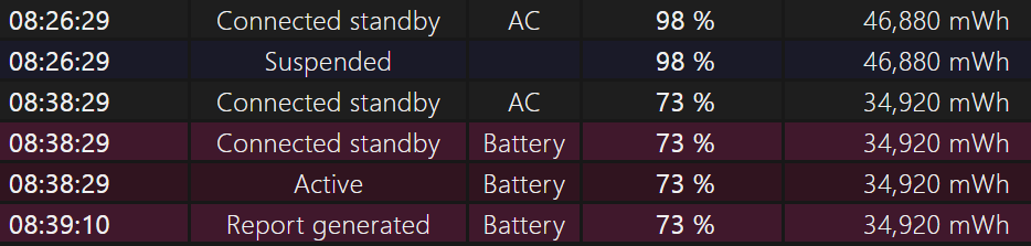

Lately, after I shutdown (full shutdown, not sleep or hibernate) my fully charged Surface Laptop 2 at night, I turn it on in the morning and find that the battery has lost around 25% power overnight! What's going on and how can I fix this?
The laptop is only about 6 months old and the battery seems to be in good health.

Please see https://support.microsoft.com/en-us/help/4469839/surface-laptop-2-update-history
This should be available on Windows Update:
October 10 release
The following updates are available for all Surface Laptop 2 devices running Windows 10 April 2018 Update, version 1803 or greater:
Windows Update History Name Device Manager Name
Surface – Firmware – 145.501.139.0 Surface System Aggregator– Firmware<br><br><ul><br><li><span>145.501.139.0 helps improve battery life.</span></li></ul>

    If it were ME, I'd join Insiders Release Preview and get the firmware and 1909. Others with SP6 have reported it solves the issue. After you get the firmware, roll back to your previous version of Windows. The firmware will still be there as firmware is not uninstallable. If that does not fix your issue, I would not recommend the SB2 with Nvidia GPU as that has all kinds of unresolved issues.
