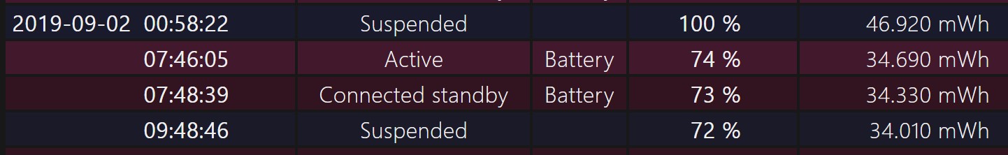

Lately, after I shutdown (full shutdown, not sleep or hibernate) my fully charged Surface Laptop 2 at night, I turn it on in the morning and find that the battery has lost around 25% power overnight! What's going on and how can I fix this?
The laptop is only about 6 months old and the battery seems to be in good health.

Please see https://support.microsoft.com/en-us/help/4469839/surface-laptop-2-update-history
This should be available on Windows Update:
October 10 release
The following updates are available for all Surface Laptop 2 devices running Windows 10 April 2018 Update, version 1803 or greater:
Windows Update History Name Device Manager Name
Surface – Firmware – 145.501.139.0 Surface System Aggregator– Firmware<br><br><ul><br><li><span>145.501.139.0 helps improve battery life.</span></li></ul>

    2019-09-26T19:55:25+00:00
    It may be too early to tell yet, but Microsoft sent out Build 18990 and came with the newer Firmware built in.  It has only been less than two days but with testing, have not had a power drop at all.  In fact, ran the machine (Surface Laptop 1st gen) for a little over an hour with general web browsing and email and it only dropped to 93%.
    Not sure if the Firmware is experimental and if is, not available for general download for others.
    Here is the Firmware that was installed:
    Good to know you are testing James 👍, but for current production machines facing the drainage issue, the fix for now is to turn off SMT via UEFI / Firmware Settings, build 1903 - 18362.356 - And from your description it seems back to the baseline norm, As conflict with current firmware does not handle super scaler well.  disable Simultaneous Multithreading (SMT) has units that I have tested operating normally as should.
