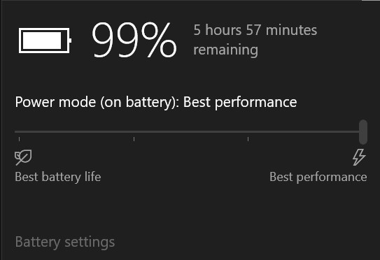

    Here is the current state of my own personal Machine:  I will give and show you guys a full update by end of day.  Keep posted.
    NOTE:  This has been tested for about 2 weeks now on other machines, ranging from SP3, SP4, SP5, SP6, SL1, SL2 & also SB1, SB2
    1. SMT = Disabled
    2. Best Performance
