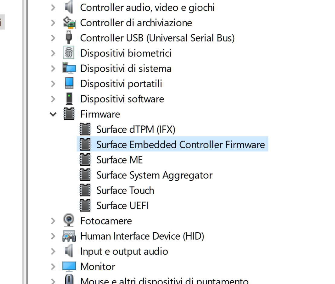

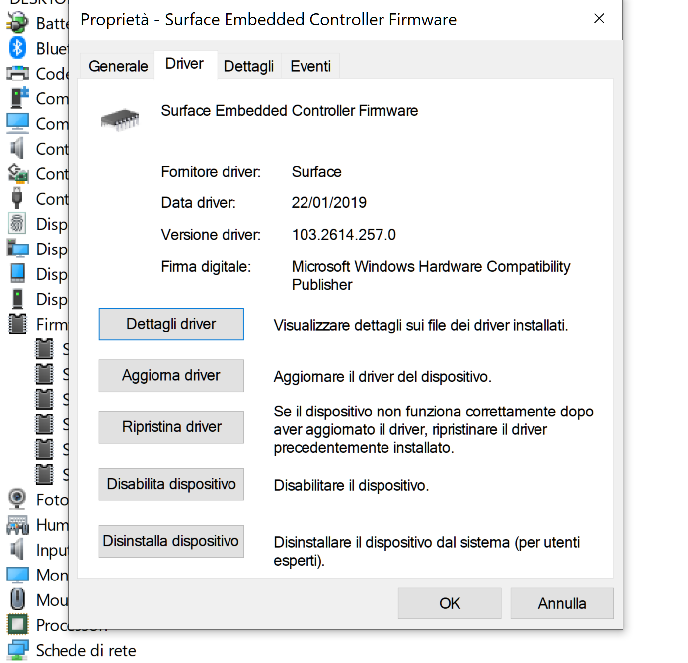

    @ Johnny W Lam
    I suppose that on Surface Pro 4 Drivers & Firmware Sept. 2019   site there will be updates already contained in the August release, then that same 103.2614.257.0 update driver. Anyhow, I'll try to do as you suggested. Thanks for your effort in helping me.
    There are also other updates that might need to be updated under System Devices, but best bet is to download the MSI package install and go down the steps provided.  Anytime josèterra , let me know if all is well once completely all tasks.
    2019-09-26T22:09:23+00:00
    @ Johnny W Lam
    I suppose that on Surface Pro 4 Drivers & Firmware Sept. 2019   site there will be updates already contained in the August release, then I suspect the same 103.2614.257.0 update driver. Anyhow, I'll try to do as you suggested. Thanks for your effort in helping me.
    2019-09-26T21:54:13+00:00
    yes, here the location:
    https://learn-attachment.microsoft.com/api/attachments/cccdcbc4-ef85-408d-b890-d935224da7c5?platform=QnA most up2date ![](https://learn-attachment.microsoft.com/api/attachments/f54dbcc3-6252-4787-a516-a06c5fd4fc57?platform=QnA
    Go the the Microsoft website that provides the most up2date Drivers and Firmware Surface Pro 4 Drivers & Firmware Sept. 2019 Download the correct MSI installer and update all Surface based drivers & Controllers.
    1. Go the URL above and download the MSI installer that is for your device and build of Windows 10
    2. Install all supporting software for Surface Pro 4 then reboot,
    3. Once pressing restart / reboot hold and turn off SMT is not yet disabled.
    4. Check for updates via Windows update.
    4A) While doing drain your battery to 4% or until it turns off
    4B) Charge your Surface to 100% / Full
    1. Test battery now.
