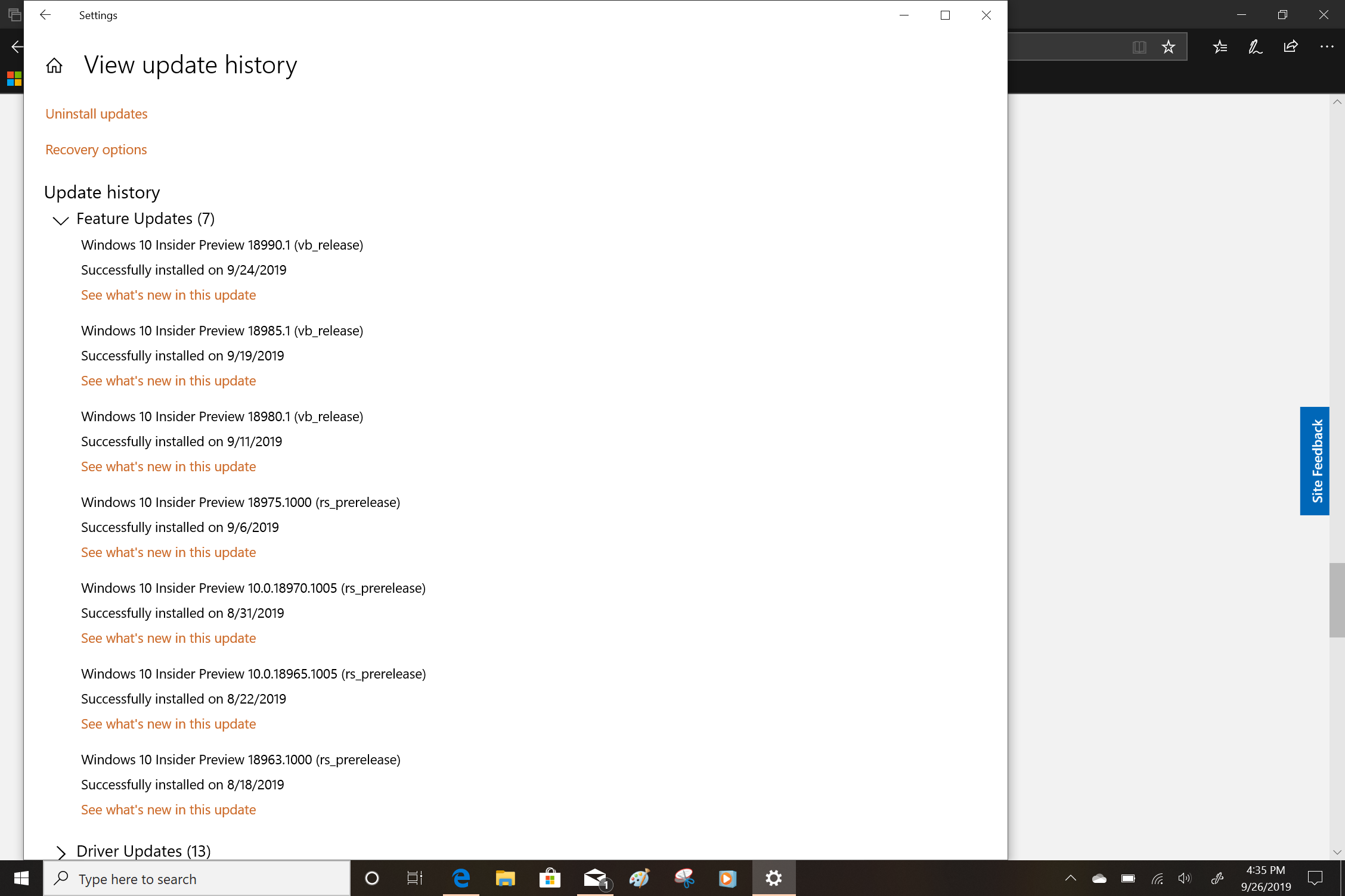

    Windows Update history is useless for displaying updates.  You receive the build and that is all it shows.
    Drivers - HP makes drivers for RTM releases and does not recognize "beta" systems and will update the driver to current, but still attempts to download the exact same driver (explains why the HP printer drivers are on the list).

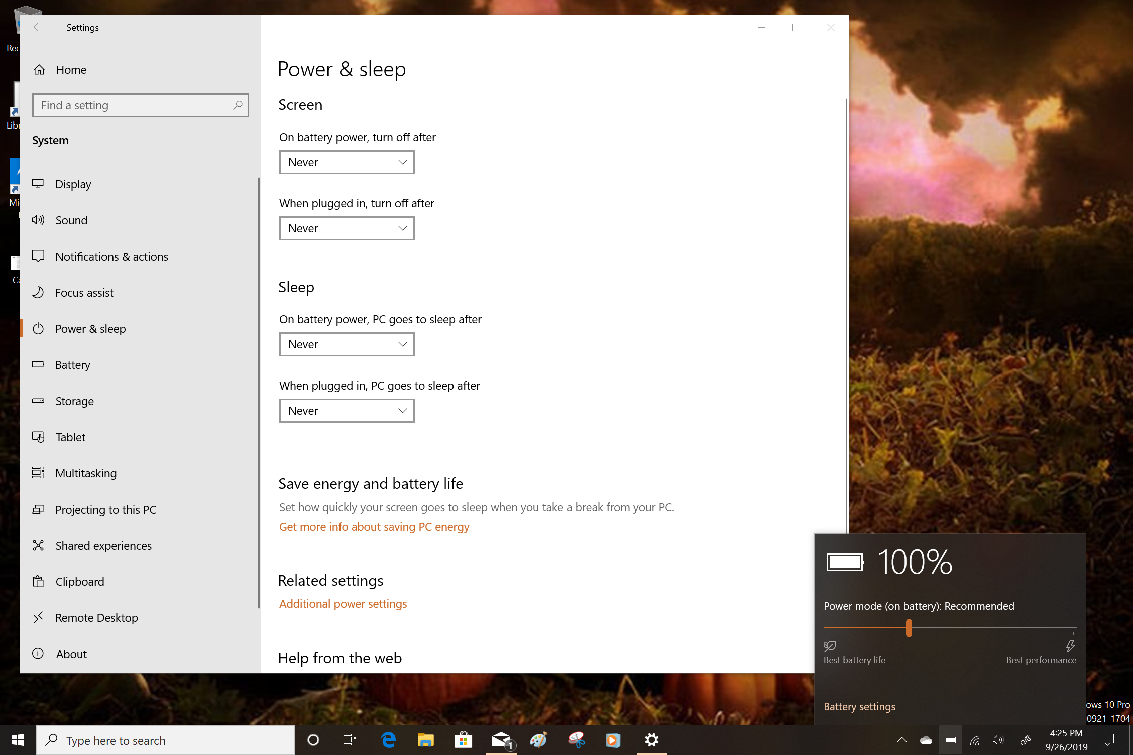

    System Settings - I shut off and keep off "Sleep" and "Screen".  The battery saver slider on the taskbar; I use the default that Microsoft sets for it and I do not change it.  This, of course, is the latest build with the newer Firmware update which is built within the Build and does not come separate.

    It may be too early to tell yet, but Microsoft sent out Build 18990 and came with the newer Firmware built in.  It has only been less than two days but with testing, have not had a power drop at all.  In fact, ran the machine (Surface Laptop 1st gen) for a little over an hour with general web browsing and email and it only dropped to 93%.
    Not sure if the Firmware is experimental and if is, not available for general download for others.
    Here is the Firmware that was installed:

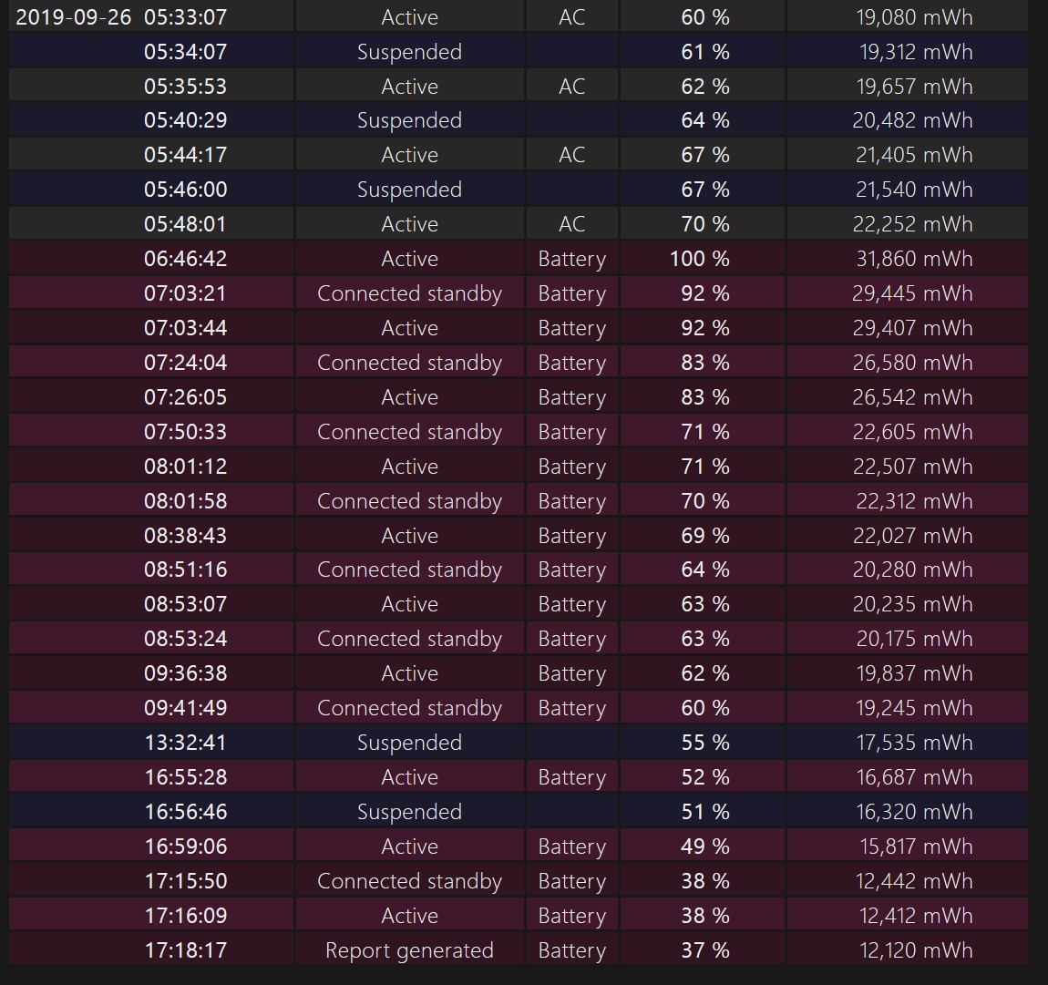

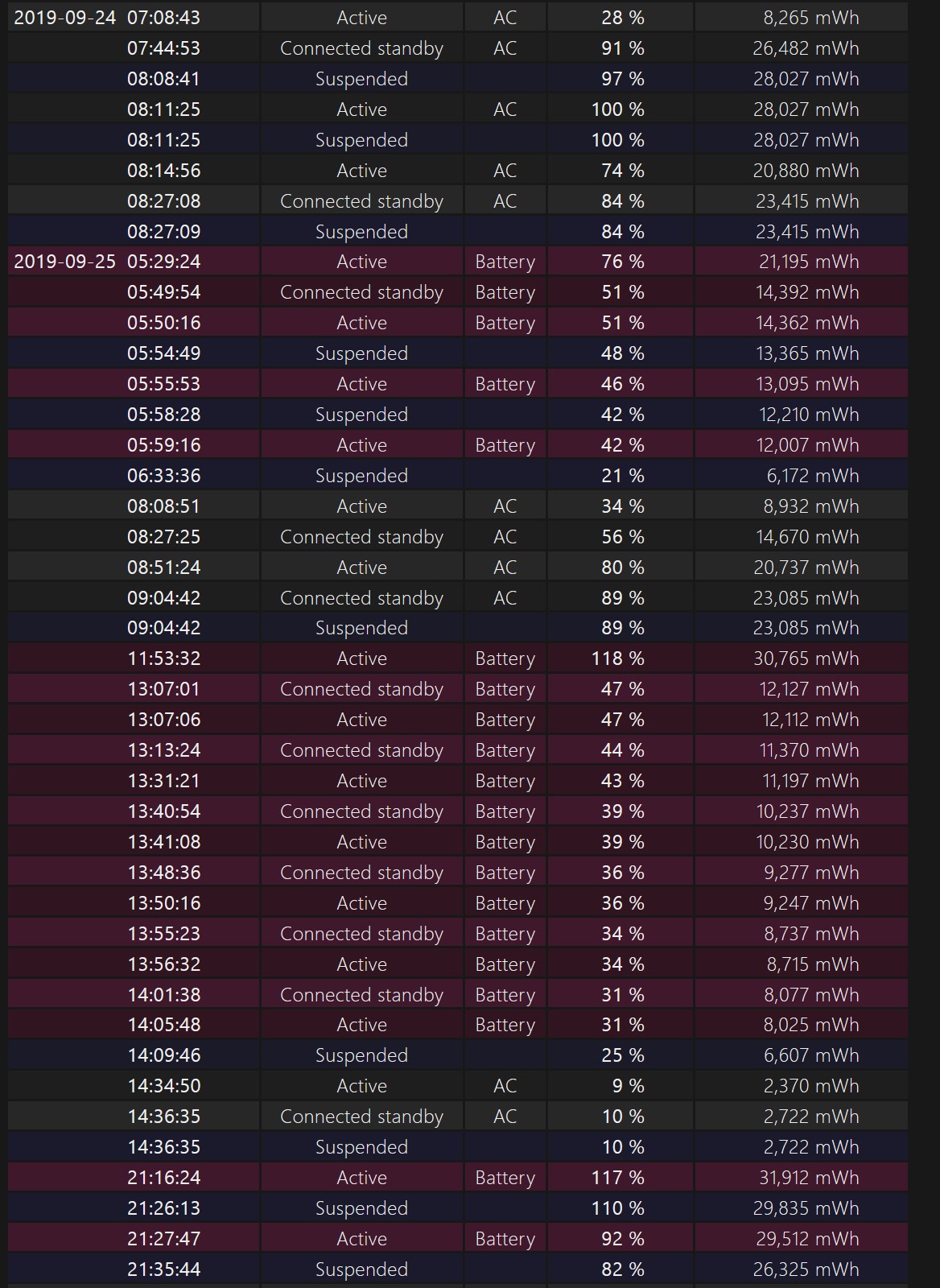

    *For a visual understanding with Data Insights.  Look below.
    Prior to turning off (SMT)
