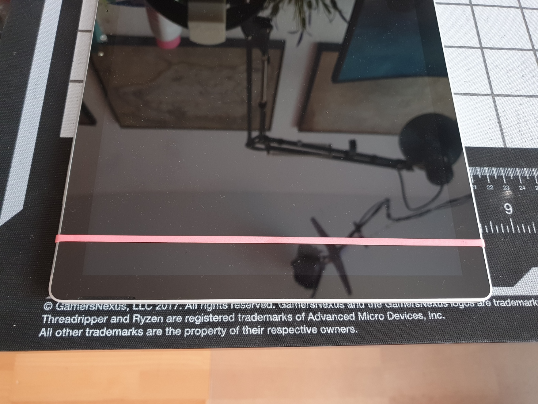

    2021-02-12T14:38:01+00:00
    strong rubber band around the power button. now we wait =P feel free to ping me in 24h
    2021-02-12T14:28:29+00:00
    hello there rt-xd, nice seeing you still hunting after a solution.
    i'm pretty sure i have had taped my power button to the pressed position overnight and it didn't solve the issue.
    i'm willing to try again, however.
    uefi being stored in the battery (as in: accumulator/battery pack) smells like **** tho. what he means is probably equivalent to clearing cmos on desktop computers, which is a fair possibility.
    that said, iirc someone disconnected the battery from the mainboard entirely (which should clear cmos pretty much instantly, since there is no backup battery on the surfacebook's mainboard) and still didn't have any luck.
    it also depends on the kind of corruption: on desktop PCs, bad settings stored on the eeprom might get you into a device not being able to boot. our issue is, however, not bad setting but a *failed eeprom flash*, as i understand it. clearing cmos wont help here cause the default settings are already faulty.
    tl;dr: taping my surface power button shut =P
