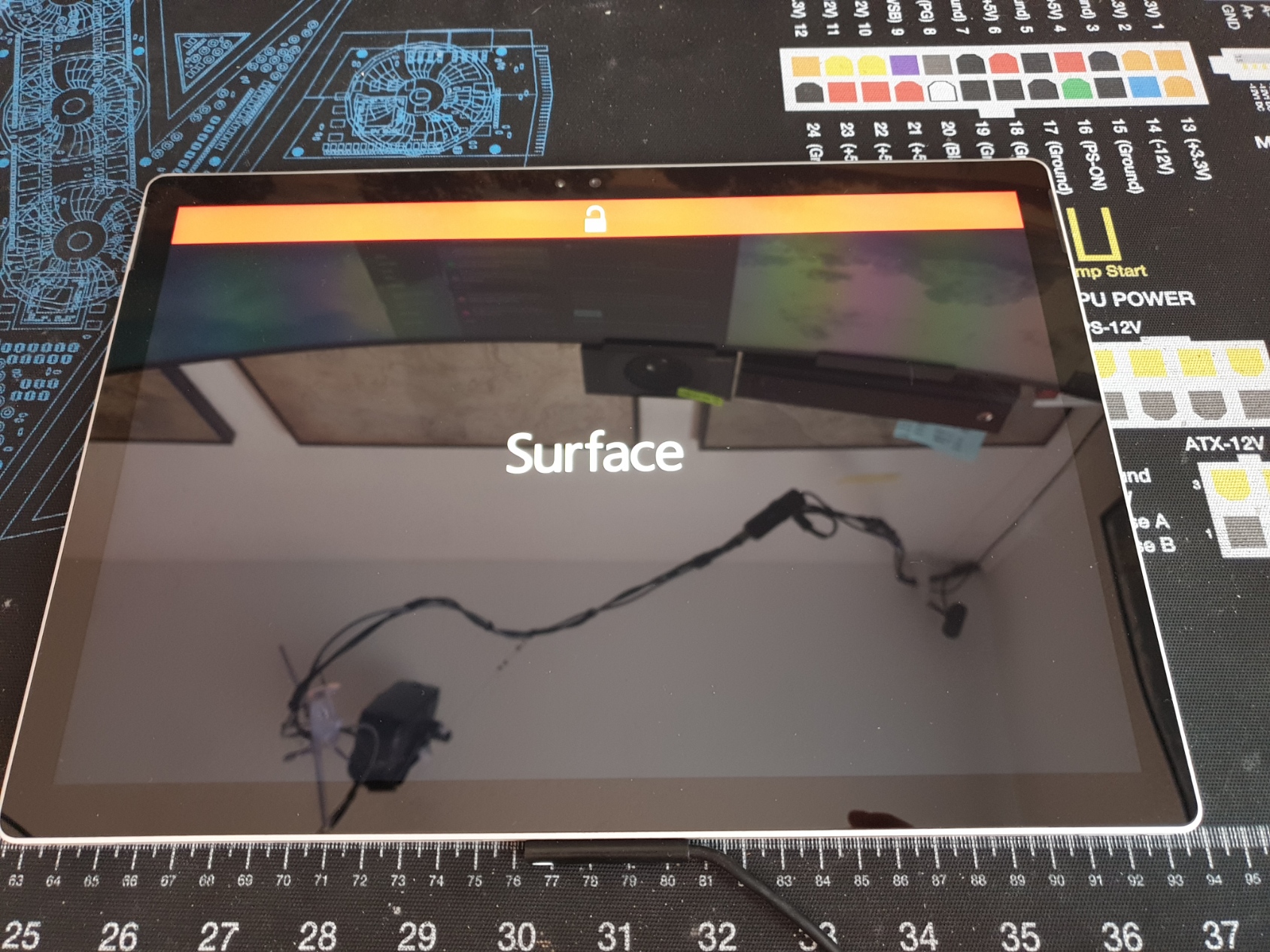

    so, powerbutton has been held for about 20h now. should be as empty as it gets as the battery management probably shut off the accumulator entirely to prevent damage.
    connected to the charger and powered it on, device is now stuck like this for the last 15 minutes:
    our issues is not solved by clearing cmos =/
    EDIT: tried to cut power again and hold power+vol up to try and get into uefi: no dice :( doesnt bootloop anymore it seems, but doesnt boot either.
