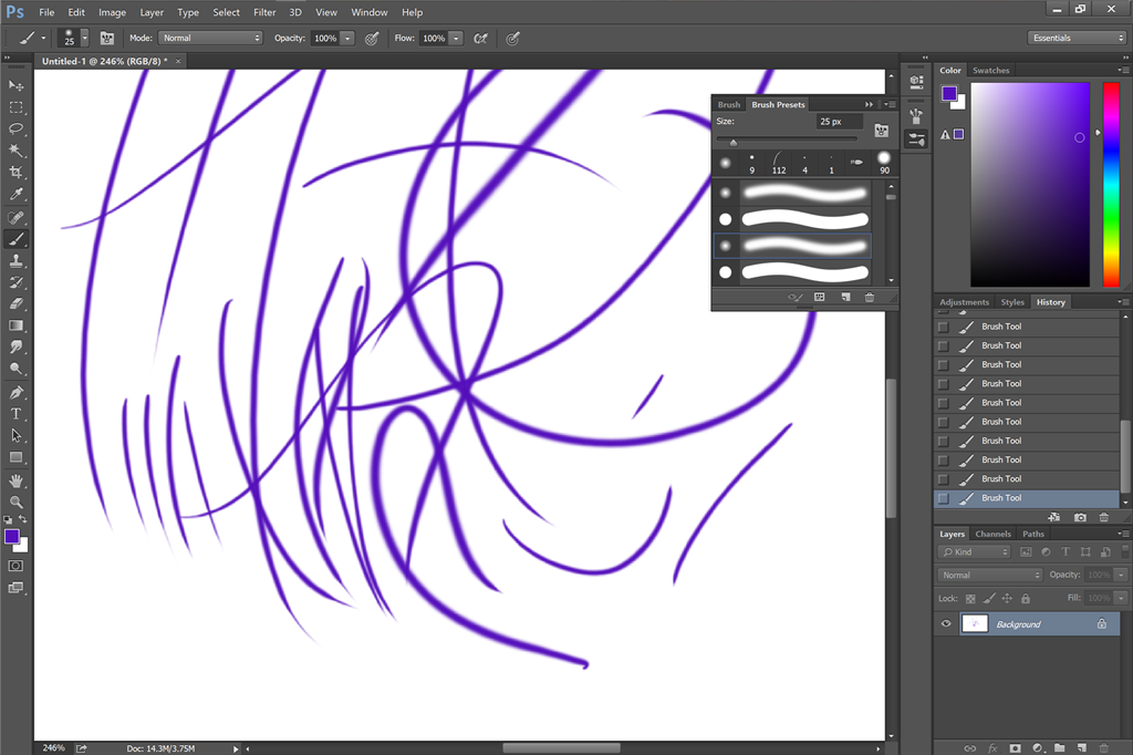

I love the new SP4 pen, but I've noticed the pen pressure is not consistent. The biggest problem is that paint brush strokes in Photoshop don't taper smoothly when drawing. I tired using the SP4 pen on my Surface Pro 3 and it doesn't have any problem. Here is a screen capture of what I'm talking about.
Since the pen isn't the problem I'm assuming it's a calibration issue with the Surface Pro 4. I downloaded new Wintab drivers to see if that would solve the problem (got the idea from this thread about pen problems).
It's not just Photoshop. The actual Surface pen pressure app has the same problem. It's harder to see because the brush strokes are thinner, but there is a much faster tapering happening than there is on the Surface Pro 3. Here is a screen cap:

As some of you have already noticed, on July 14th, 2016, we released an update to the Surface Touch Driver that should significantly improve the pen tapering and pressure experience that this thread talks about.
For more information on the 7/14 update, you can go here.

    The tapering issue highlighted by the original poster, Brad Colbow, and Dave martins, it's 100% a software issue (the same pen works well on a SP3).
    But the activation force required to register a stroke? I'm inclined to think that it's a hardware limitation, present in every ntrig pen. I hope to be wrong.
