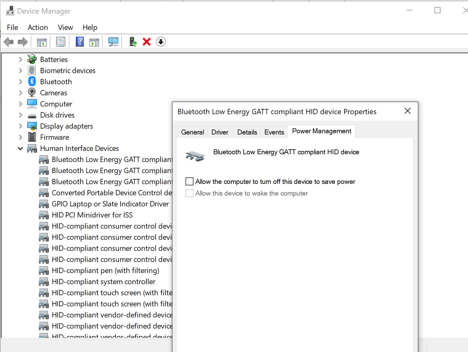

I can pair my airpods with my Surface book 2 laptop, however they will rapidly connect and disconnect. And when it says "connected", no sound will play through the airpods. I've tried looking up a couple of fixes online but nothing is working.

I had the same exact problem with the Airpods Pro. My problem, as you mentioned, was the the rapid flickering back and forth between Paired andConnectedwith the Airpods ultimately never connecting.
For me, the solution was to restart the whole process as follows:
  1. Place your Airpods or Airpods Pro back into the case > Close the case > Set the Airpods down.
  2. On your Surface computer > Settings > Devices
  3. Select Add Bluetooth or other device > Bluetooth
  4. Pickup Airpods Case > Open Airpods case (Don't remove Airpods) > Press/Hold button on back of Airpods case until the Airpods are located by your Surface computer.
Your Surface computer should be able to at least find your Airpods by following the above steps.
*This is where I started having the problem stated at the beginning*
Solution:
  1. Go to settings > Type "Device Manager" in the search box.
  2. Once Device Manager is open, select Human Interface Devices
  3. Locate Bluetooth Low Energy GATT complaint HID device > Right-Click >Properties
  4. Select the 5th tab called Power Management
  5. Locate the checkbox "Allow the computer to turn off this device to save power" and UNCHECK this box!
  6. RESTART COMPUTER! *(This is what ultimately fixed my problem)*
Hope this helps! Wish it wasn't this complicated but oh well ¯\_(ツ)_/¯

I couldn't even find a "Bluetooth Low Energy GATT complaint HID device"  under Human Interface Devices, and any other Bluetooth options in the Device Manager didn't have a power management option. However, when I clicked on "Converted Portable Device Control device properties" under Human Interface Devices, I found the power management option and disabled it. My AirPods are working correctly now. I hope I'm not saying this too soon and that it's not just because I just updated my Surface, but I've had this problem for a long time and updates haven't fixed the problem before. Hopefully this will work for you. It's unfortunate we have to deep dive into our settings to get headphones to connect right.

    There is no “change settings” button or anything with power management.
    Mine has an option. I'll try to upload a screenshot. You have to go to Device Manager->Human Inferface Devices-then right click to select properties. Then an new interface opens and it has a tab Power Management. That tab has options. When I clicked on that tab originally, the box allow this computer to turn off this device was checked. I unchecked it per instructions above and that did the trick for me.

    HI, I finally found something that worked from an earlier post. At least it has held now for a while.
    This was posted by someone earlier and has been working for me.
    It was the second part of this post that helped me: I'm putting that first and then if you need the first half, it is below second:
    Solution that worked for me:
    3. Locate Bluetooth Low Energy GATT complaint HID device*> Right-Click >*Properties
    This was the first part of the post above in case you need it.
    3. Select Add Bluetooth or other device*>*Bluetooth
    Solution:
