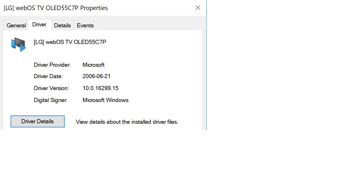

    Robert,
    I just checked on both my Surface Pro 2 and HP laptop.  When I Show hidden devices...Miracast display devices, both computers are identical.  They both show the same LG TV (of course), and they both show the exact same driver.  The HP laptop connects flawlessly, but the SP2 does not connect.
    2018-02-17T20:26:52+00:00
    That's what I see too.  See if your symptom changes with Update driver, Browse my machine, Let me pick...  I think there may be a chance for a refresh that way.  Also, see if you can have your Control Panel's view of your adapters open at the same time.
