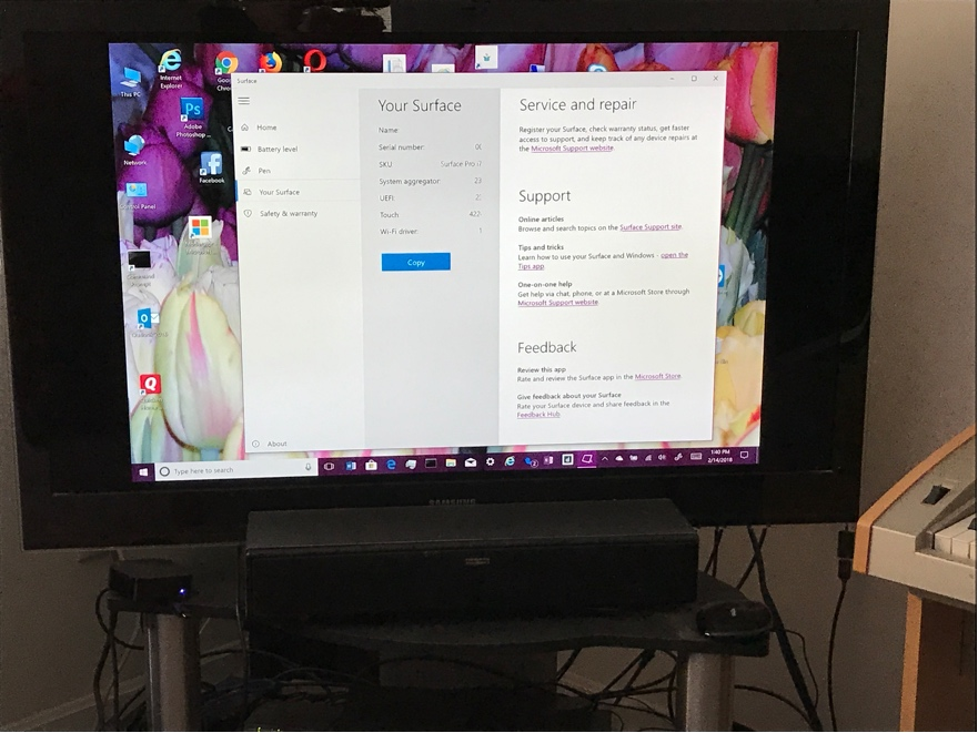

    My TV doesn't have onboard Miracast. SP3 would have the same wireless chip as mine which is not the same a original SP and SP2.

    Thanks for the update from your end.  It is good to know that you succeeded, although it would be even more significant (promising?) if you were connecting directly with a TV rather than a Microsoft add-on dongle.
    I suppose it is possible that only the SP and SP2 have this problem.  I am still awaiting feedback from the third chap in our group regarding which SP he has but unfortunately it turns out that he is actually away until next Tuesday.  Both the other chap and I believe his is an SP3, but we would like to get actual confirmation.

    I've pinged my contact again. I don't have a SP original or SP2 to test with (they have the same Marvell wireless chip). I do have a SP 2017. I have a second generation MWDA.
    I'm running 16299.248
    All I can do at this point is wait and see if my internal contact responds with either more troubleshooting requests, a fix, or an acknowledgement that there is an issue. In the meantime, it would not hurt to file this via the Feedback Hub App and let it collect the logs.
